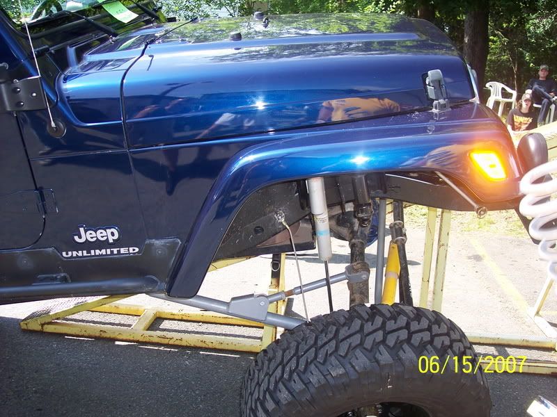

No need for limit straps. Even a lifted KJ can't get this kind of crazy flex:
Note the spring in the judges hand to the right of the photo.
Edit: Speaking of crazy flex, don't forget to vote in this month's ROTM contest.Image
