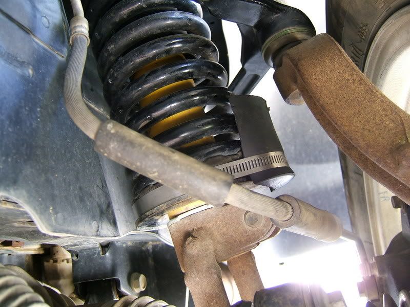

You need to add a set of bumpstops to the daystar spacer as pictured below. If you got it from All-J, I assume they will send you the bumpstops free of charge-- that is what they are doing for Frankenlift owners.

Hey Eddo, in that 2nd pic where the UBJ isn't contacting, isn't the a-arm still contacting the spring above it though...it kinda looks like it from the pic???
Looks like I'll just bumpstop it for now and then when the funds are good enough dive into some Al's Arms and Moogs...
Nope, hard to tell from the angle, but about 1/8" of clearance. Not much, but just enough.

Still though them angles on that upper ball joint are just horrid!!!!!! :shock:

PostPosted: Thu Dec 07, 2006 9:44 pm
Thats why I made my bumpstop so thick.. 8)

What is it you used anyway?...looks like a chunk of rubber with a hose clamp around the bottom of the spring/strut assembly...

PostPosted: Thu Dec 07, 2006 9:48 pm

Still th eangle is there though. I guess it is not like that alll the time anyways so its not like it really would hurt anything anyways, but if you lifted one of them tires and fully drooped them enough I could see it doin damage.

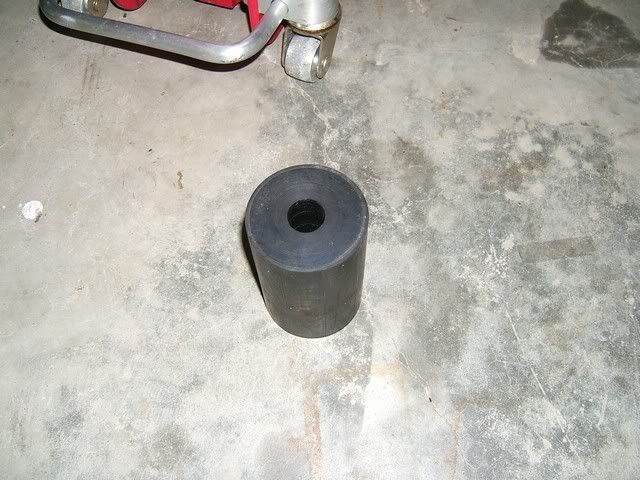

PostPosted: Thu Dec 07, 2006 10:36 pm
I used a spacer for shaker sceens in a Coal Prep plant..
It has fibers going through it so its VERY strong.. Was fun trying to cut it up. :lol:
