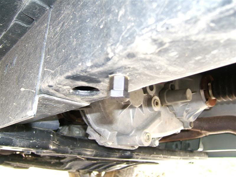

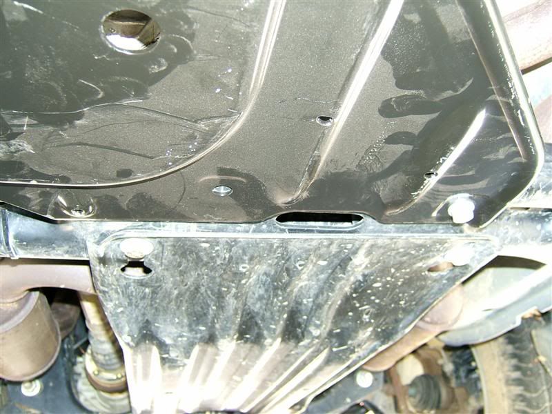

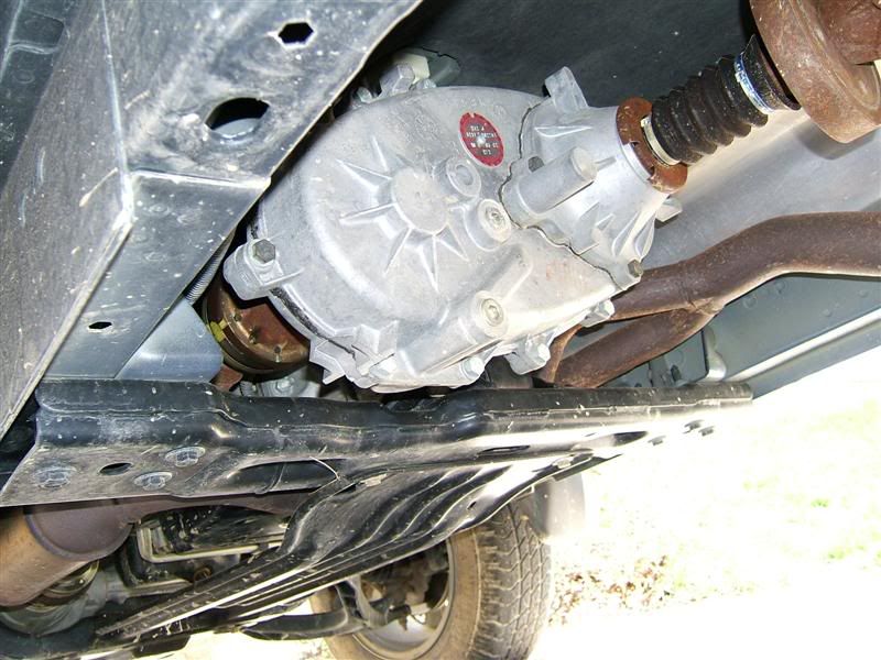

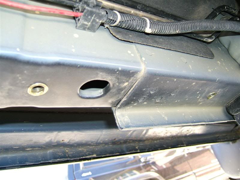

PostPosted: Sun Dec 17, 2006 8:41 pm
only on the computer.. :wink:
Hold the wrench in the pic in place and tighten the bottom bolt to 25ftlbs. I would be sure to not go over 25 ft lbs b/c i stripped mine alittle.

Holy cow, Jeepjeepster, you should be in customer service!! I didn't expect the pics THAT quick! Thanks again, I really appreciate it! Gives me a better idea of what I'm in for. Did you say you got the install tool with the skid? I got the skid with no installation parts, and I'm wondering if I can get the tool at the same time I get the zerts from the stealership.
Thanks again, man!
