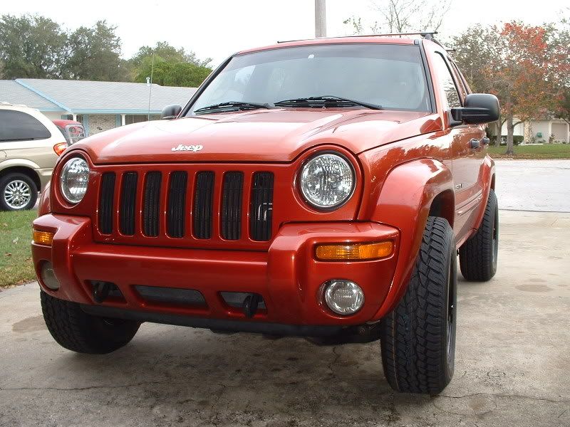

I just installed the 16x8 Series 51's with a 4.25" backspace and love the look/fitment. Perfect as far as I'm concerned.
Here is a link to a recent pic of them installed...
http://img.photobucket.com/albums/v258/ ... 0031-1.jpg
