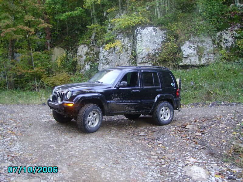

I have a 2004 limited with the off road package. It has taken me everywhere we have wanted to go. The only problem I have is that my clearance is a bit low for some of the stuff we do--mostly moderately rugged fireroads with occasional rocky stream crossing. I have scraped the skid plates with boulders sticking up in the middle of the road.....yes, yes, I konw, put your tire on the obstacle. Sometimes you can't or sometimes you are looking at the lesser of two evils (rocks) I am considering getting a small lift to raise up the skid plates a bit.
Here is a pic of the trail I run frequently.....as you can see nothing too exteme.
So the question is, will adding 1.5 inch spacers retain my current ride while giving me a bit more altitude to handle these rocks. I want someting that will cost less than a grand $$ installed, preferrably more like $500. I am running 235/70R16 Goodyear Wrangler Silent Armor AT. I like the tire, but am considering my next tire being a 225/75R16 or 245/70R16 Discovery AT (much lighter tire=better fuel economy). I don't want anything that will make my vehicle more tippy on windy mountain highways and I don't want a substantially wider tire because that will diminish performance in snow.
