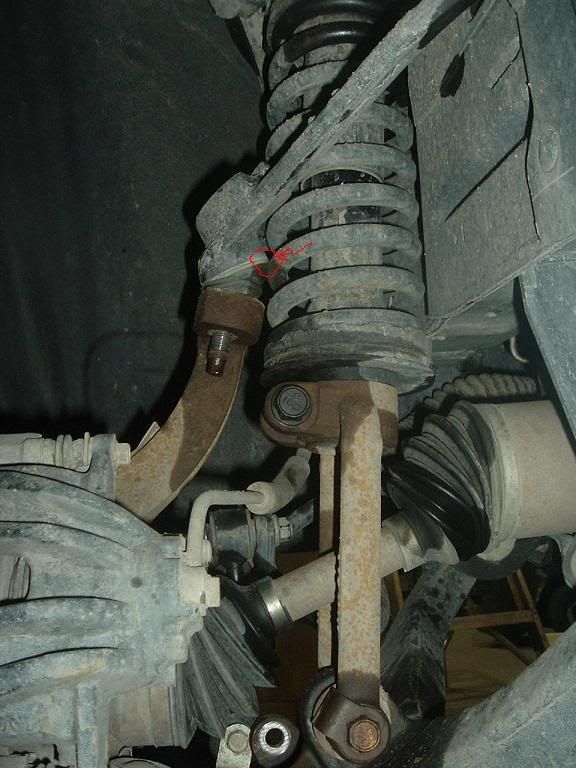

RRO sells a lot of those OTT kits by using a lot of false info about them on their website. You WILL need to do some extra work to make them work right. You WILL need an alignment after installing it. You WILL be getting some contact between the upper ball joints and the coils. If you have the RRO OTT spacer kit, please, go take a look at your struts. If they don't have some sort of poly/rubber wrapped around them to prevent the ball joint from hitting them, then jack your front end off the ground (with chocks behind and in front of the back tires, then take a look at your struts. Are the ball joints sitting on the coils? Without some sort of stop, I'll bet money they are. All it takes is hitting a bump or a dip just a little too fast, and this will result in a broken ball joint or upper control arm, at best. Worst case... well, best not to think about it, really. Do it right, get a suspension lift, and enjoy your Jeep. Sorry this is so long but, that OTT kit just scares the hell out of me, now. I highly recommend that EVERYONE stay away from Rocky Road's "Budget" lift. Just search for more posts by me to see the kind of damage it can do and what it will cost to fix. For a little more than an extra hundred, you can get Rusty's suspension lift... would have saved me thousands, had I gone that route the first time.

PostPosted: Tue May 01, 2007 10:46 pm
Posts: 1325
Location: Casper, Wyoming
I never said that an OTT kit couldn't work, just extra work. No, I'm not pissed or anything. I just want people to be aware of what they're getting into. RRO implies, heavily, that no additional work will be needed with their budget lift, when they know that's just not true. And, for what it's worth, I have to disagree with the opinion that the Rusty's with a clevis is the same as an OTT. I'll get some pics of my setup, now with the clevis to compare to the OTT kit but for now, here's the problem I had with the OTT kit:
Make sure to put some poly or rubber between those to prevent that.

PostPosted: Tue May 01, 2007 11:44 pm
Posts: 633
If you look back at my last post you will see that I said some were still getting some contact depending how far they raised the strut out of the clevis. So,I would bet for you to gain 3 1/4" of lift like I did,you would need more coduit nuts.And eventually if you raise it enough,you will have contact.I have'nt installed the RRO OTT lift,but mine is Rusty's OTT lift and at full droop I had about 1/4" between upper balljoint and coil spring.And to stay on topic,the original poster said they don't do any heavy offroading,just an occasional trail,but mostly road driving,so as long as they understand that the OTT is not for hardcore wheelin',then maybe this is all they need.Mine has been on since july of 2006,been off on easy trails 3 or 4 times,and I can promise you I have no paint missing on my coil springs,no leaking or blown struts,tight upper balljoints without torn boots,and even quiet cv joints.One thing I think we can all agree on is that the more you expect from IFS suspension,the more it's going to cost you.
