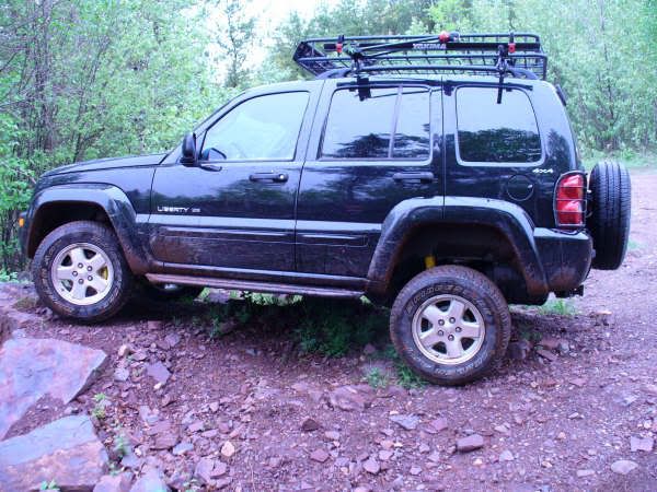

I hope you mean my Liberty cause here it is.
