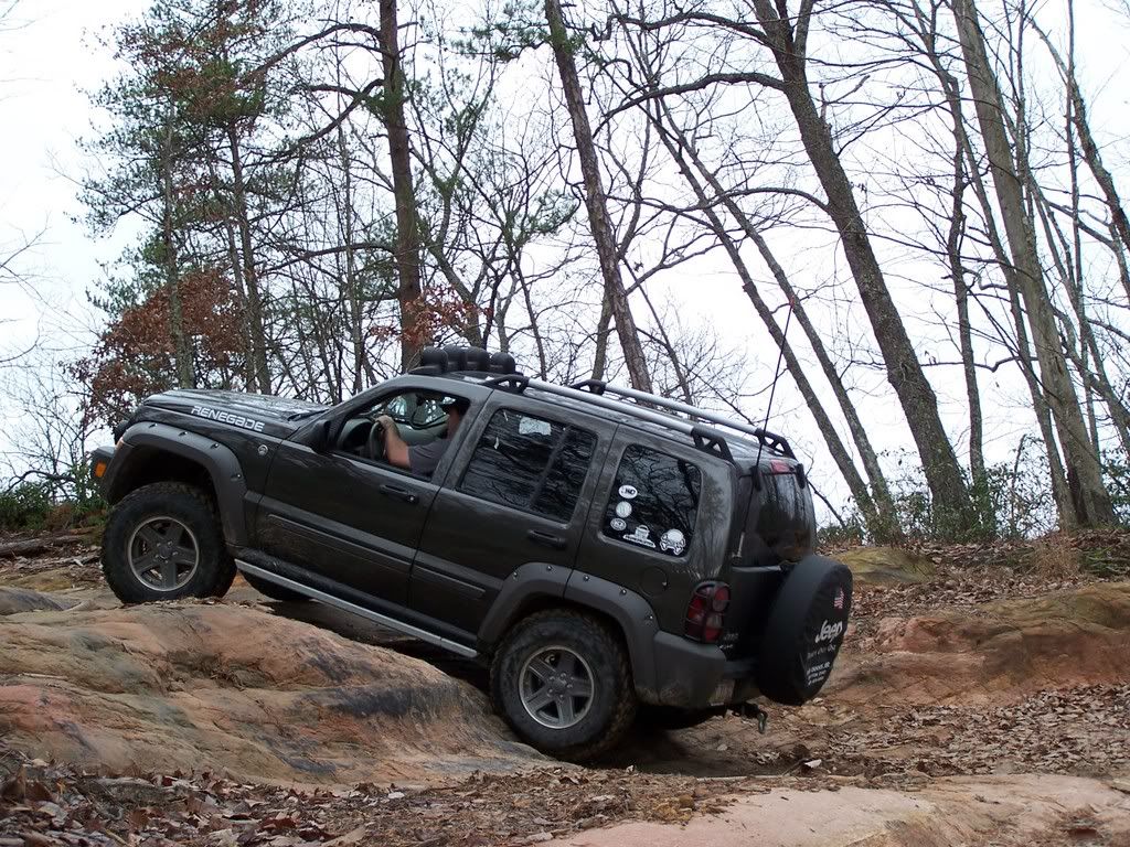

I'm running 265/75R16 Interco Trxus MT's,they are 31.9" tall.Zero rub in the front and only slight rubbing on the front of the rear wheelwell.

those tires are nice.... saw another Libby on
here running the trXus.... r they better than MTR's
in your opinion?
I see you run the spare on top..... Can you not open the
glass with your spare back there?

PostPosted: Mon Jul 02, 2007 10:35 pm
in your opinion?
I'm just testing the Trxus out before I commit to a 35" tire for the SFA,so far they are not to bad(the MT/R's are my first choice still).I only put my spare on top because the 265/75 MT/R and a 16x7 steel rim is tipping the scales at 85+lbs and was taking it's toll on my rear swing gate hinges,and yes the rear glass would open no problem with the spare mounted on the swing gate(I didn't enen flip the tire carrier either).

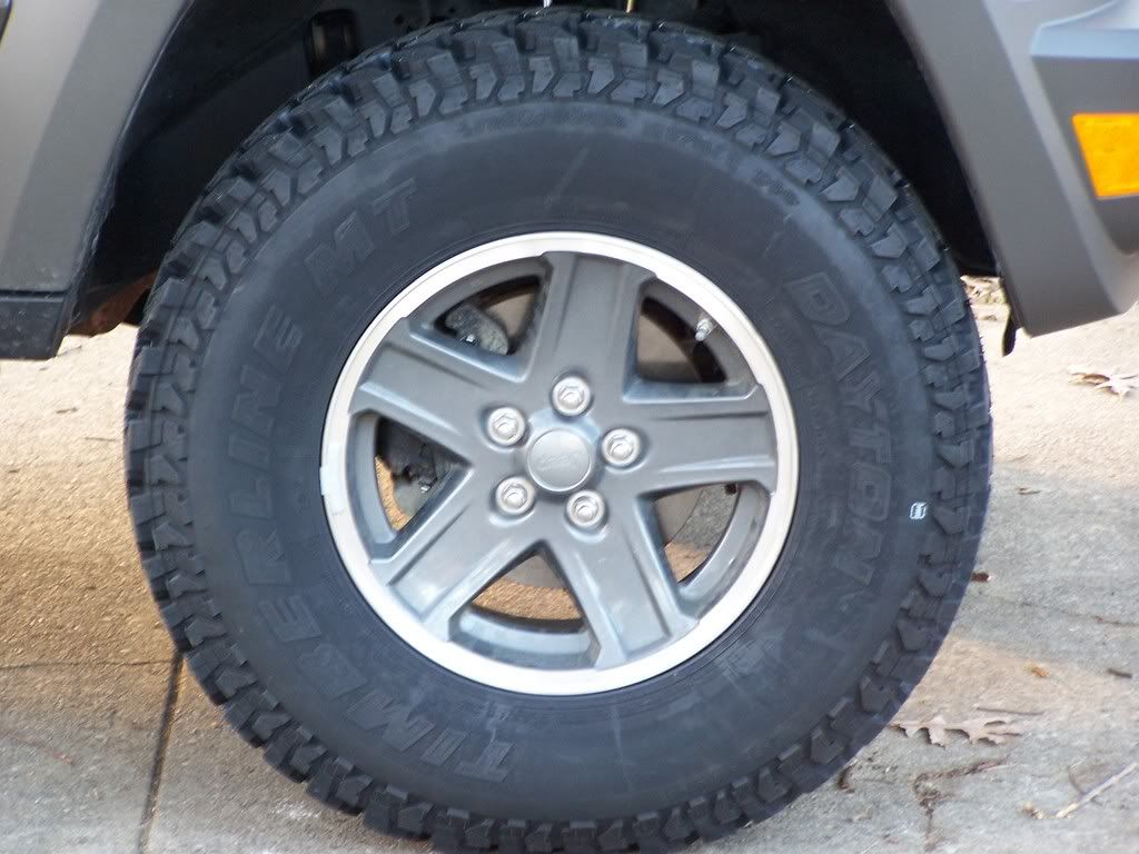

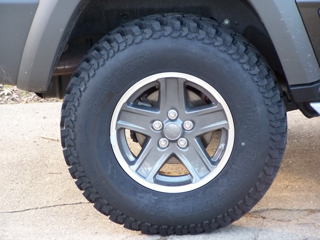

235/85R16 Dayton Timberline MT (32.0" per manufacturer) $129+ tax USD out the door!

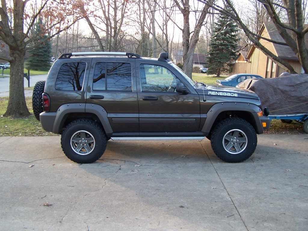

There are quite a few of us running 265/75/16's. These are my old TrXus MT's, my new 32's
are Buckshot XMT Mudders, 6 ply with full siping and 3 ply sidewalls for only $99.00 ea..
Those seem to fit really well, narrow and tall. Any rubbing?

Sport wrote:
Well, once you trim the lower air dam, and a small bit of the bumper (oh, it's not that bad, and you can only see it if you lay down in front of the jeep), pound the pinchweld, and do a little trimming on the wheel well liner... then you only have to decide if you want to move the washer bottle. I also recomend installing longer bump stops. I would highly recomend these tires & size.

moose wrote:
Sport wrote:
I like them, I might put them on my stockers. do you have wheel spacers.
oh and i don't even have my liners anymore.. :)

No wheel spacers - you might catch the flairs that way... As for bumpstops, I recomend adding bigger ones. I didn't, and you should have hear the sounds she made when I stuffed the first time :D :shock: :twisted:
