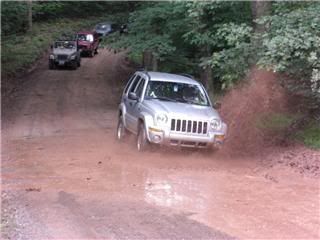

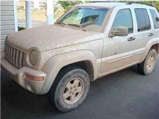

I was out doing this on Sat which is what led to me wanting to change the fluid. I am going to do the diffs too and I already took care of my transfer case. Had I not broke the stupid bolt I would have been rockin.
