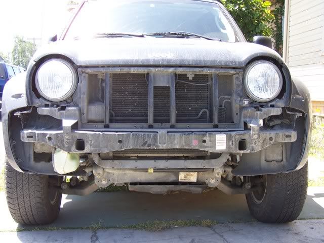

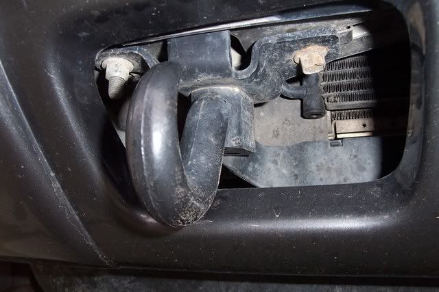

I put the stock hooks on my 03 without taking the bumper off. A ratcheting wrench will help, so will smaller hands. If you have man hands, I think you'll have to take the bumper cover off. Here's what it looks like off.
Tow hook
Took off tow hooks and added a bar instead later
