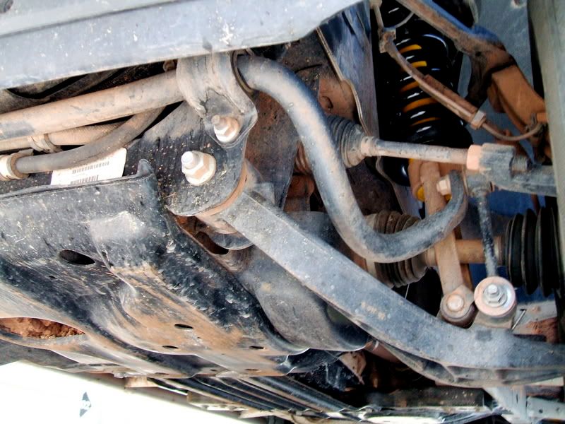

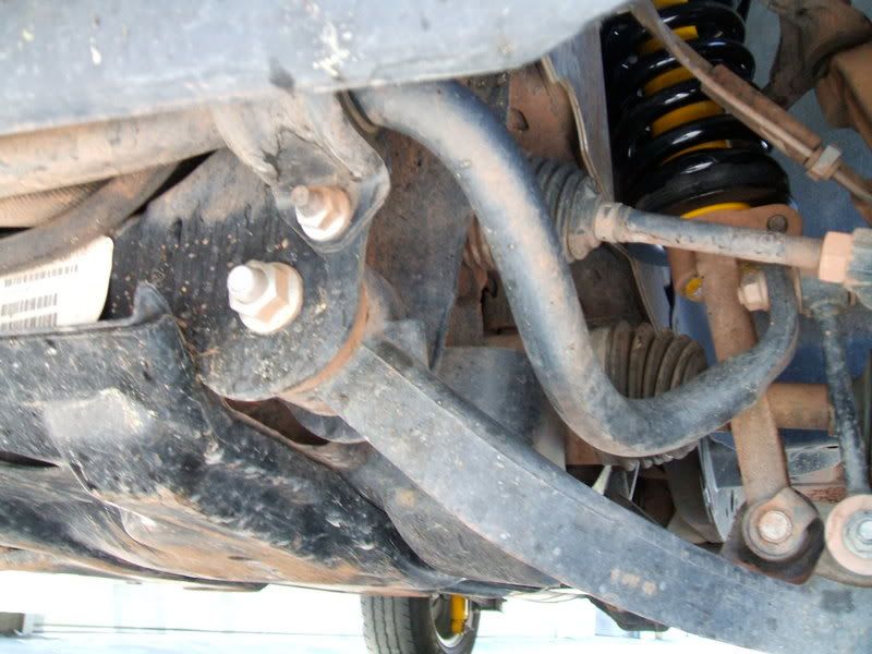

Now here is my concern. Driving home last night I drove over a speed bump and there was a pretty significant clunk. I backed up and went over it one tire at a time and no clunk. I drew the conclusion that the sway bar was loose. I looked underneath and saw that the swaybar hits the lower control arm. Does anyone else find that the two are very close in your lifted KJ's?
Anyone know a solution to the problem? I am getting significant clunking and it's only a speed bump!

I have had clunking since the JKS discos-- pre lift. It only clunked back then when one side hit the obstacle and not when both went over at the same time (I figure it is because the bar is not on real tight with the disco's--- just a pin holding it on). Since I have lifted it I still have clunking... but not any more than before and I have not noticed it being any different (happening when both go over).
Yes the bar and the control arm are very close on mine as well. I never gave it a second thought, as I figure the sway bar has to go up if the rest of the LCA that it attaches to is going up-- so I figured it was not an issue. Looking at the bar and the arm, I see a very small shiny spot where the arm and the LCA would meet. So I suppose it is making contact (it is small-- width of a pen mark and 1/2 inch long). There is no groove or indentation, just a spot. I am not sure if this occured when I discoed and forgot to attach the lanyard, however (lots of clunking then).
I will keep an eye on the future clunking this weekend when I drive it again.

Take off the sway bar and see if the "klunk" goes away...If it does, then you might be able to grind a small amount off ...or... find a way to relocte the sway bar a bit higher...a longer sway bar link or adjustable one.
