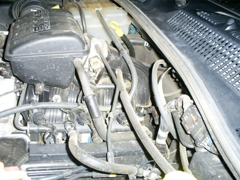

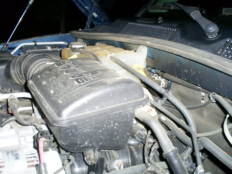

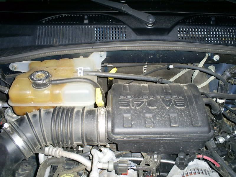

Any of these help?

Ya see the nipple just north of the hose clamp on top,,,does that have a hole in it into the bottle
PostPosted: Thu Oct 18, 2007 11:22 pm
