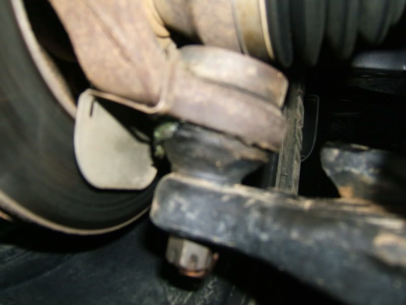

Are you sure its a boot and not just a cover?

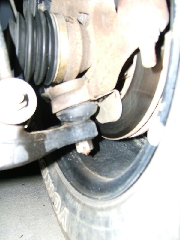

Yup, thats what I have. Its just a cover that slides over the entire boot. It works ok, but its not as good as a regular boot.
This is the boot that had a hole in it. You can tell its not as plump as the other side.
