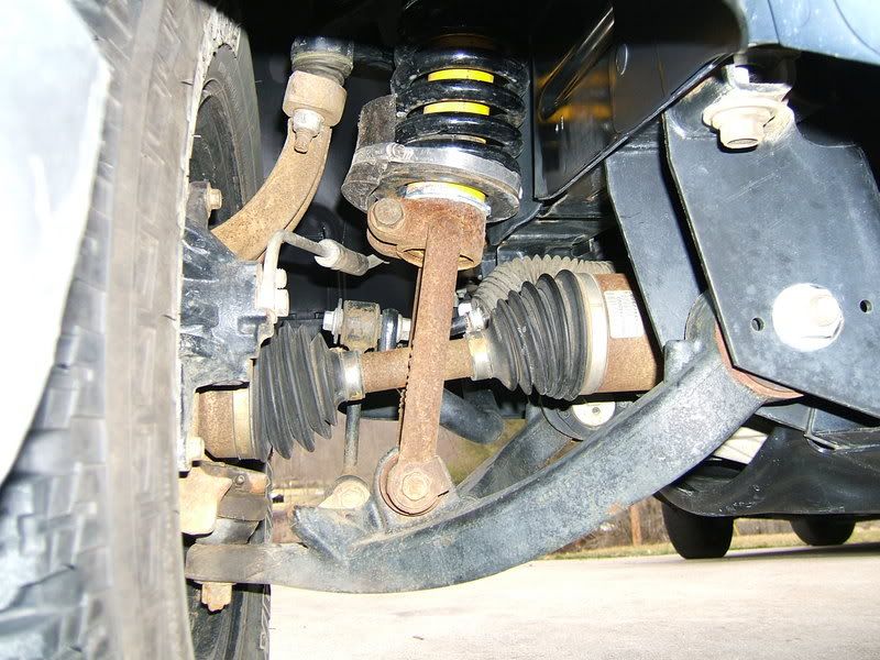

[img][img]http://thumb6.webshots.net/t/64/564/5/83/86/2030583860089391346QCZfve_th.jpg[/img][/img]
Here's a shot of mine, the new ones are much better! Joe

If you have the OTT lift that that is most likely your problem. Your best best would be to go to a different lift or add some extension bump stops. I'm sure Blake will post a picture or something. The OTT lift (Over the Top) will cause the upper ball joint to contact the spring and rip the boot.
Al's arms are at a different angle and have a large steel bung and will stop the ball joint from contacting the springs, but will clank around.
PostPosted: Thu Nov 01, 2007 8:37 pm
Like eddo said, you can make a bumpstop to prevent the a-arm from hitting the spring. I do NOT have an OTT lift, but my clevis lift causes the balljoint to get really close to the spring, so I made a bumpstop just in case.
http://img.photobucket.com/albums/v612/ ... CF6889.jpg
An OTT lift also causes the shock to bottom out before the the upper control arm hits the bumpstop. So you have issues in both directions when using an OTT lift.

The new poly parts in the frankenlift has an integrated bumpstop similar to yours.
