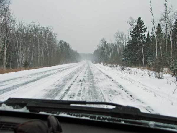

Why Selec-Trac? Why not just Command-Trac? I've seen this issue pop up in many forms over the few years I've been haunting this site & KJ Country. Well, yesterday I drove almost 300 miles in a winter storm, so I had a bit of time to experiment. Here is a photo from mid-afternoon along Minnesota Highway 61, between Duluth & Lutsen; Lake Superior is about 100 yards on the other side of the trees on the left. This area got 10" of snow, & this is about mid way through. The day before, it rained then froze.
2WD was simply out of the question. Part time 4 WD seemed like the logical answer with this much snow & ice, but it was squirrelly. Not uncontrollably so, but it certainly had that on the edge of controllability feel to it. I then pulled it up to Full-Time 4 WD, and it became stable, I was able to hold a speed near the posted the whole way home, even as conditions worsened. Only 3 people passed me... I saw them later, waiting for tow trucks to yank them out.
This is the reason I converted my KJ from Command-Trac to Selec-Trac. It is clearly the best option for where I live & drive

From the pic I don't see why you would need 4wd anyway,really I don't,guess to many winters in SD.
Never had a problem with my command-trac being squirrelly,god love the TT!!!!!! Pulls me anywhere I need to go,even on ice,better then ESP and TC.Never had a problem with any of my 4x4 in 4wd in any surface,just point and shoot.Now my '01 Grand had select-trac and kinda sucked compared to part time 4wd,pretty much if I needed 4wd I was in 4lo anyway.

Yes, the plow had been through, exposing the glaze of ice that had accumulated the day before. In my opinion, I'd rater be on an unplowed road of snow than a sheet of ice. Most of the drive was at night, when photos could not be taken, in pack snow.

Not at all! Part-time is great for off road, I'd not even consider using full time for wheeling. But full-time has it's place, & many on this board have asked where that place is. This is where full time is much better than part time. the benefit is that with Selec-Trac, I have both Full & Part time. Which is great up here.
