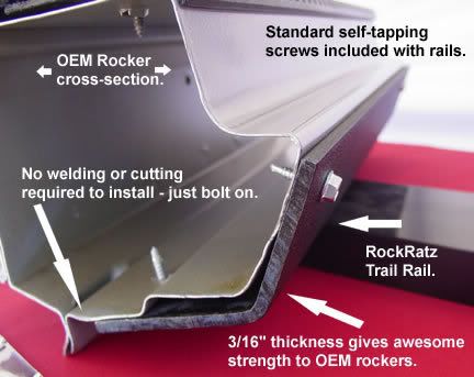

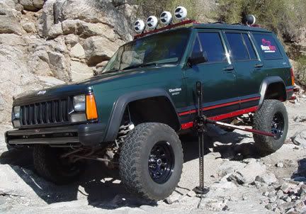

Something like this would work on our KJs, right?, well prolly not these exact ones but Im thinking that I could prolly make some, and use some 12 screws to hold it on and spread the weight, but they are nice, simple and have a low profile what do ya think?

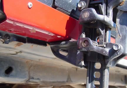

I saw those a few days ago as well. They might be alright but, I wouldn't want to come down on them very hard at all. I did this to a set of Rock Lizard's Skinks. KJ's are heavy!

I'd be hesitant to drill holes in a Jeep's rockers...Jeep rockers tend to rust out with no aftermarket holes in em...

Ya know, I was thinking about this just yesterday! I see wranglers ALL THE TIME with very very similar set ups. I hate the fact that my sliders steal so much clearance...
But, I would maybe try to build off of what you have picture there and take it back to the frame rail somehow so its supported somewhere else.
couldnt you just goop some silicone along the edge of the rocker guard to keep water out? might help...
-Jon-

You could but you'd want a way for any water to get out that does get in there or you'll really have a rust problem.
