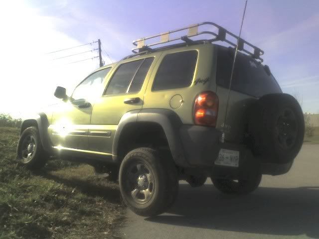

here is a pic of the diff longer shocks make.. 1st pic is stock shocks 2nd pic is with RSX Rancho 17004s.. sorry i forgot my camera at the house when i took both of these pics so the smartphone pics will have to do...
the back tire is about an inch off the grownd in this pic. also note where the top of the tire is in relation with the bottom of the bumper.
the back tire is flat on the grownd and the top of the tire is level or below the back bumper.. i couldnt even get the tire off the grownd (yet)
