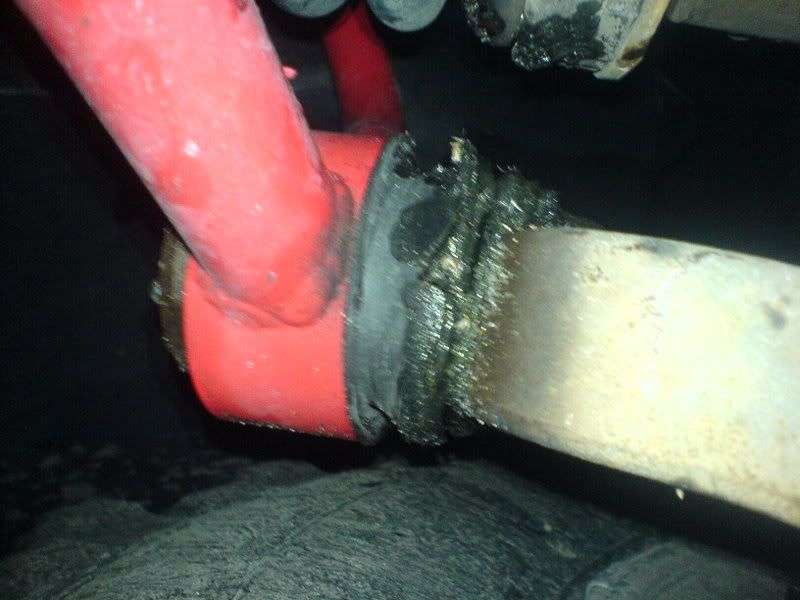

Ok so i got a set of 245/75/16s MTs used today. when i took them to put them on they came out and said they wouldnt fit.. i said no they should i want to see. and sure enough the tire was hitting the UCA and to mount for ball joint. i couldnt believe it :shock: . i then explained how i was a member of this forum (LOST) and there were plenty of guys running this tire size and i didnt understand why this didnt work for me. my stock 235 tires u can just fit ur hand between them and that spot :?:.. i do have a Rusty's lift but i havent had an alignment yet. so my question is why did this happen to me and so many other are able to run this tire? is there anything i can do to fix this?? the guys there told me to get wheels spacers but i would rather not ($$$) and another guy told me he had wheeled for years and u could get and extension for the UCA???? also they said the reason why everyone else could but i couldnt was because they had offset wheels.. i told them that people were doing with the stock wheel and they then said that mine we just different ( i have the 16" sport steels).. i am going back i the morning to see if the spacers will work so i need help on this fast cause i dont want to use them.. so any help is welcome please....

edit: i just checked to see if my stock tires were still close sitting on the grownd and they were. i could just barly put my finger in between it and the ball joint. is this right?? i seen a pic on here and they were close maybe but he has bigger tires on. here it is but kinda hard to see.

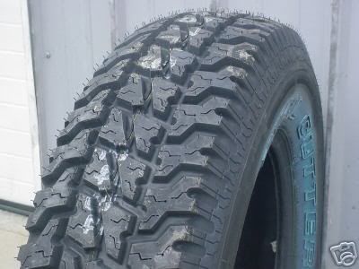

alos they said it was because the tire was square and not rounded.. i know that sounds dumb but there right the tires tread is fluss with the side wall. if this helps they are BigO Big Foot X/T s

It looks like those bigfoots have more of a trapezoidal profile than a lot of ATs out there (the middle of the sidewall sticks out much farther then the widest portion of the tread). I'm sure tire measuring techniques vary between companies. I'll bet they measured the tread and not the overall width.
