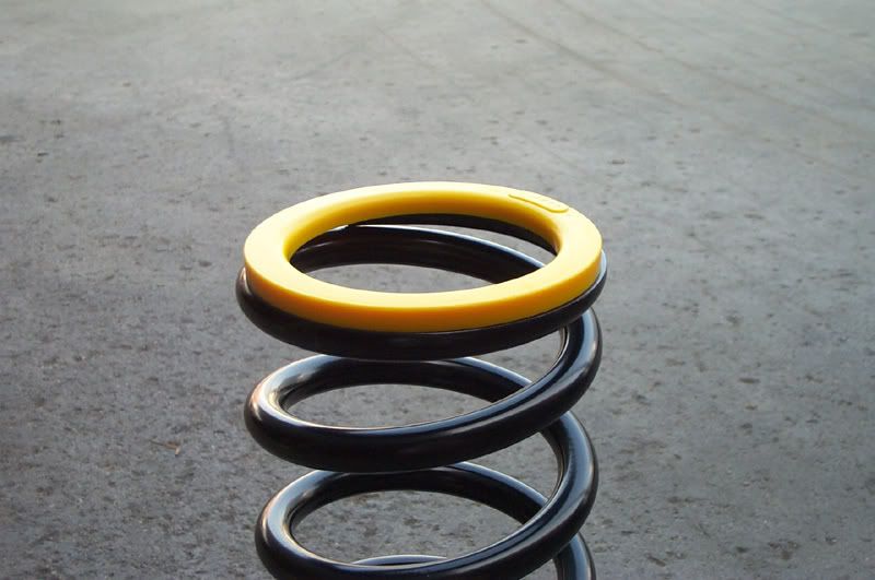

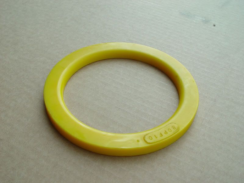

Does anyone run the black front (steel?) trim packers made by rocky road?? When i ordered from their site i ordered the trim packer..thinking it was the complete OME kit(front & rear yellow rubber) however upon delivery it was one front 3/8" black metal trim spacer made by rocky road...so I ordered another one for the other side :lol: Anyone run these? (On a side note: I guess OME doesn't make that trim packer kit for KJs?)

I had never heard of a trim packer until you came up with it then looked on the OME site. Those, what you have are the same as Rustys sell or what I had made up myself from some scrap steel, they will give you about double their thickness in extra heighth.

Looks like it serves the same function as a rear spring isolater. I don't see any mention of use for the front springs.
From OME:
Some vehicles will list whether or not matched or unmatched springs are fitted. These vehicles just want to lean. The Old Man Emu 10mm Trim Packer is designed to act as a shim to level out listing vehicle. Fit a Trim Packer to to the rear spring on your vehicle's low side to level things out. Always fit the Trim Packer to the the top of springs only, and not on the bottom.

The 3/8" front spacer are commonly used by folks with ARB bumpers to help level things out
(and the past usage of 'trim packer' was the poly spacer for the rear - tends to be used if you want articulation and a 265/75/16 tire)
