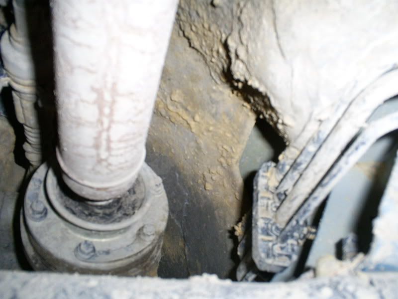

PostPosted: Sun Mar 02, 2008 4:59 pm
Where'd your CV boot go?
PostPosted: Sun Mar 02, 2008 5:09 pm
Posts: 1322
Location: Richmond, VA
i guess you are referring to the picture...thats the rear of the driveshaft...the cv boot is in the front portion, where the shaft connects to the front diff.
L.O.S.T. #225019
2003 Sport 4x4
Patriot Blue w/ trail rash
Flex-Zilla 4" Lift
TrailRash hi-lift mounts
PostPosted: Sun Mar 02, 2008 5:18 pm
The rear of the front driveshaft has one too,yours is MIA,that's why that CV joint failed.
His looks exactly like mine does.

tjkj2002 wrote:
:shock: :shock: :shock: :shock: :shock: :shock:
how in heck can it come completely off??????
the service manual doesn't show a rear boot.

PostPosted: Sun Mar 02, 2008 5:55 pm
Never seen a service manual picture of that region, but i'm pretty darn sure mine has a boot :lol: if you don't have a boot on a CV axle, it WILL die in VERY short order.
PostPosted: Sun Mar 02, 2008 5:58 pm
It shouldnt have a boot covering the entire joint Jeep4me. This is the best pic I can find but Ill get a better one if its needs to be gotten. The boot is turned towards the inside so it looks like it doesnt have one, but its there.
You can hardly see it.

That's interesting since my front driveshaft has a boot on both ends,granted it's a '02.
PostPosted: Sun Mar 02, 2008 6:02 pm
I must be missing something.
Yours looks just like his... And mine.. :lol:
Look closely,you'll see his boot is missing or severly ripped and missing part of it,you can see the socket in the CV joint(look at end of arrow,1st pic),my pic(2nd one) has a rubber boot clearly covering the CV joint.
PostPosted: Sun Mar 02, 2008 6:12 pm
Posts: 1322
well here is some pics of a shaft i'm about to purchase. in one pic you can see a clamp that looks like it would be to a cv boot.
This is everthing I need right? Anyone know the torque specs for the bolts?
***Edit, just went out and checked, I do have a front boot, you can see the clamp for it in the picture TJKJ just posted.....problem is, i was able to stick my finger through it*** :shock:

PostPosted: Sun Mar 02, 2008 6:19 pm
Excellent penmanship tjkj:D
And after seeing the bottom of JeepJeepster's KJ again...I feel like a slob :lol:
Like that did you :lol: .
Jeep4me99 that pic of the driveshaft you are going to buy shows that the rear CV boot is present on the shaft,it it is not torn you can't tell since it's only a side shot.The CV boot is not like the front CV boot,it's part of the joint itself.
