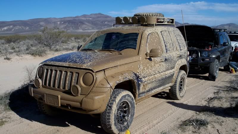

I don't have exactly what you asked for, but mine is a con ferr roof rack welded to crossbars that mount dirrectly to the factory holes. Makes the rack much lower and stronger, although mine only covers about 2/3 of the roof.
Hope you can see it under all the mud :P
I got this rack from Wally (allyrand). He set it up with a hi-lift, ax, and the lights that are visible. It also has CB antenna mounts in the back and a shovel mount. Both JJ and Nanette have similar racks on their KJs.
I'll post some mudless pics tomorrow.
