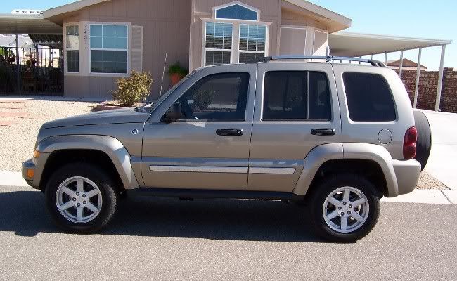

You get the same amount of lift with light OME front springs and medium rear springs that you do with others, just a softer spring rate. I got more than the advertised 1 1/5 inches. No, my stock springs weren't tired. We put the OME's on at about 10,000 miles.
The ride is as good as or better than stock on the street and much improved over dips and off-road. Gas mileage was not changed. We used the Rancho shocks and struts.
