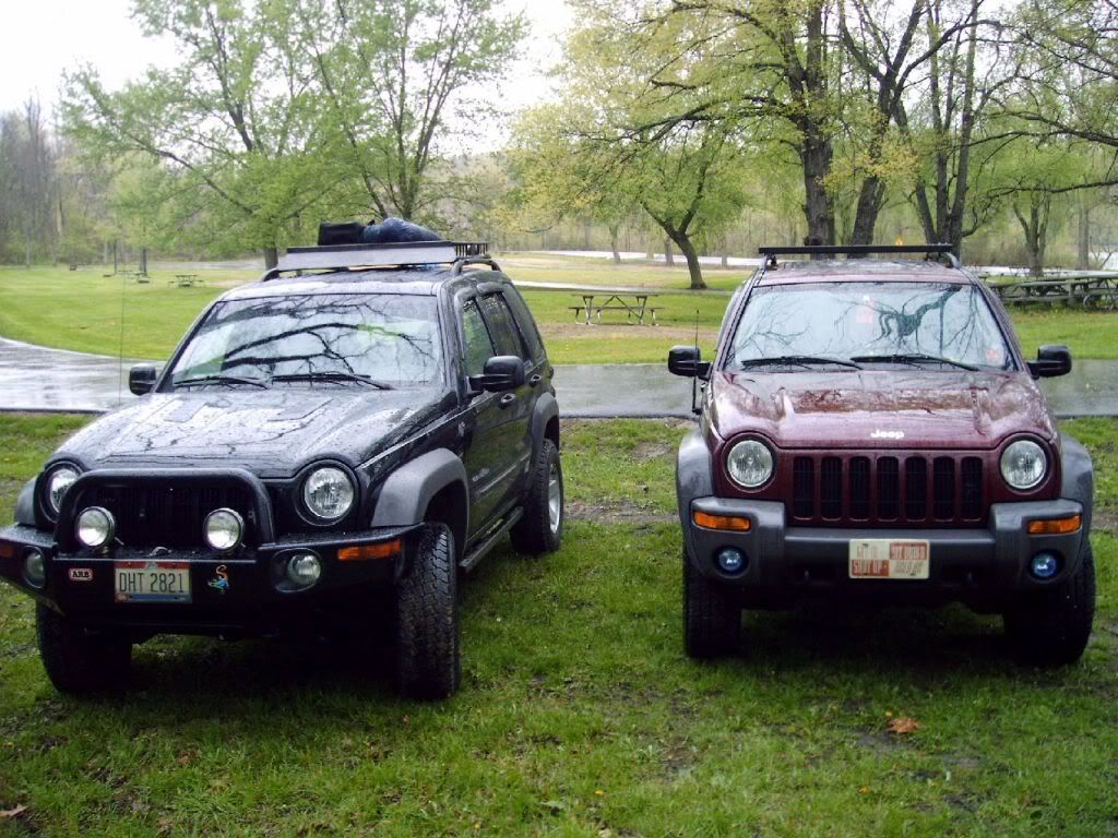

I have an 03 with the 2½" Daystar with Skyjacker long travel shocks with 255/7-/16's on it. It's only been on for a couple of months but so far I love it.
Here's a couple of pics:

PostPosted: Mon May 05, 2008 11:04 pm
Good Looking KJ there 501, seems like I have seen that one somewhere in my travels??????? :wink:
PostPosted: Mon May 05, 2008 11:09 pm
Posts: 2053
Location: Michigan City, IN
Hmmmm.... I wonder where?!?
I kept running into this rig over the weekend a few times!
L.O.S.T. #DW090501
