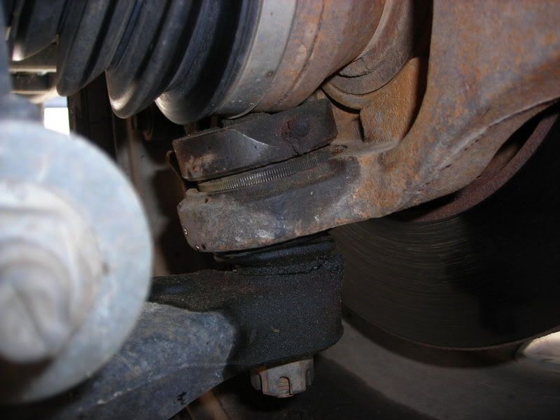

This weekend when I tried to put some grease in my MOOG LBJ I found out that the right lbj was out of the knuckle!!!!!
When the KJ is not suspended in the air the lbj is in it correct position, BUT when the KJ was lifted the lbj was pulled out from the knuckle, the lbj is not damaged.
I remove the knuckle and I found that the hole for the lbj for some reason was deformed (I don't know the correct expression) and now it is bigger
As I could not get another knuckle I decided for a temporal solution, I put 3 solder joints between the lbj and the knuckle
Here you can see the pics for this
DOES ANYONE HAD THIS PROBLEM BEFORE?????

Uh...is it just me or is there a giant crack running through your knuckle? I wouldn't trust that setup as far as I could throw it to be honest...
PostPosted: Sun Jan 27, 2008 6:48 pm
Thats what I was looking at as well, think he has some serious problems there

Might just be a scratch.

that is NOT a scratch...that's definitely a crack. scratches aren't uniform through irregular surfaces...that vehicle is UNSAFE. get a NEW balljoint and a NEW knuckle ASAP!

Looks like a crack, but could also be the grease spatter from heating up the ball joint. looks like there is a discontinuity in the middle Photo is too grainy to really tell.
Definitely worth taking a close look.

Hey guys, thanks for your concern, but stop....
This is not an scratch or crack
Sorry but the pics have not good resolution as I took them with my stupid cellphone
As you mentioned bugnout, that was grease, BUT not from the lbj or my KJ, we were working on other car and a guy put some grease bottle near the knuckle and he spill some of it over the knuckle
The problem is in the knuckle, I have an extra pair of lbj and I tried to insert into the knuckle and I could, with not too much force, the lbj is not older than 2 months, the hole is bigger but there is no indication of a crack on it

I had the same thing happen, about a year after I installed the Moogs. I figured I'd have to get a new knuckle, but a mechanic buddy of mine (very carefully) welded the joint onto the knuckle. So far no problems, but I'm keeping a close eye on it.
Actually, I don't have to watch it too closely--if it ever breaks loose I'll be able to hear it from inside the cabin. When it broke loose it was pretty noisy going over bumps.

Finally I replaced the knuckle on my KJ, I delayed this for so long time!!
But now no more problems, also I found that suspension needed some adjustment, there were some noises, the bolts in the lower arms where unthigtened!!!
Thanks to all for your comments!!

Yes I was driving with that condition for some weeks, just from my home to my work and return, I live 10 minutes away from my work and also I stop jeeping for a while untill I fix this problem.
