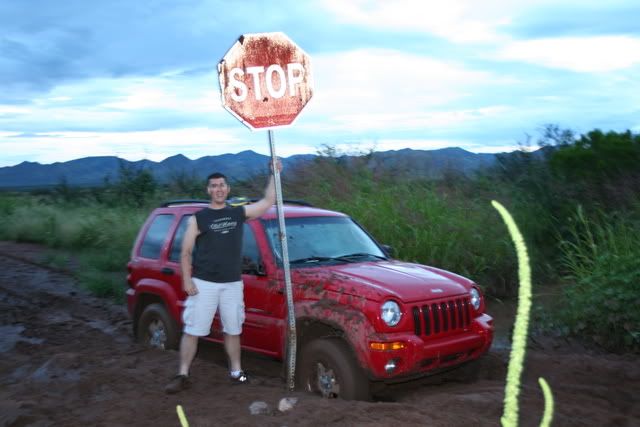

Well I just recently traded in my Tahoe for a 2002 KJ. I've been very impressed with it on the mountain trails so far, though I've been giving my front skid plate hell on the rocks. ( oh well that's what its for right?) The thing is that I just found my first big mud hole to try out the KJ in. It didn't look like much, so I don't even think to put it in 4WD before I plowed through it. Well that's exactly what my front skid plated did. It acted as a plow at first and I came to slow but firm stop in the mud. I tried my darndest to reverse and go forward as much as I could before it was effectively high centered.':?'
(that's me after I tried digging myself out with this STOP sign I, uh, "found")
I was slightly disappointed since this was something I could have parked in two wheel drive with my "HOE" and tore right on through.(It has twice the clearance) Well getting on to the purpose of this post, I decided that I need to lift my little JEEP up a bit. I've read into it and it seems to be that I can only lift it 2.5 inches. OK fine. I've also read that the Frankenlift II Premium is the "Holy Grail" of lifts to put on. OK great, I don't have to guess. The main question I have is concerning CV angles. Right now mine seem to be at a slight negative angle. What I mean is that the part of the shaft coming from the diff side is lower than the part of the shaft going into the wheel. Not by much mind you maybe an 1/8 of an inch. They almost look straight unless you lay on your belly and really examine them. I've read a couple posts with people snapping CV's possibly because of the HD coils on the Frankenlift creating to much of a CV angle. I've just contacted All J Products to order one. I would like to get some feedback as to whether it is safe for my KJ's CV shafts, or am I OK since my current angles are not... well theres no real angle to them.

By the looks of your picture, I've got two comments. First, it looks like you have the stock tires or A/T's at best. They aren't very good in the mud. Second, you couldn't have been digging very hard because your shorts are still white :lol:
Well even if they were slick 50's they would have went through the hole if I wouldn't have bottomed out. My shorts are white in the picture because they took the pic before I had gotten down on all fours and started digging with my hands. Sure if I wanted to go swimming I probably could have dug myself out in 3 or 4 hours at best. I decided instead to call my buddy with his old International Scout. He walked it right through and pulled me out with his wench. Thanks for the replies guys, I appreciate it.

Did you put the stop sign back in place cuz I would hate to have caused an accident as a result of it missing.

Yeah I stuck it back in its hole, but I don't think the road really needed one. It's way out in BFE, and if you're coming from the road to see the stop sign, you already know to stop.
