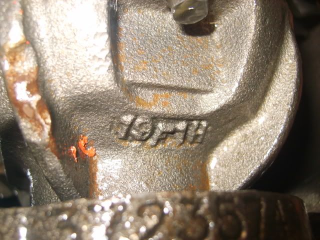

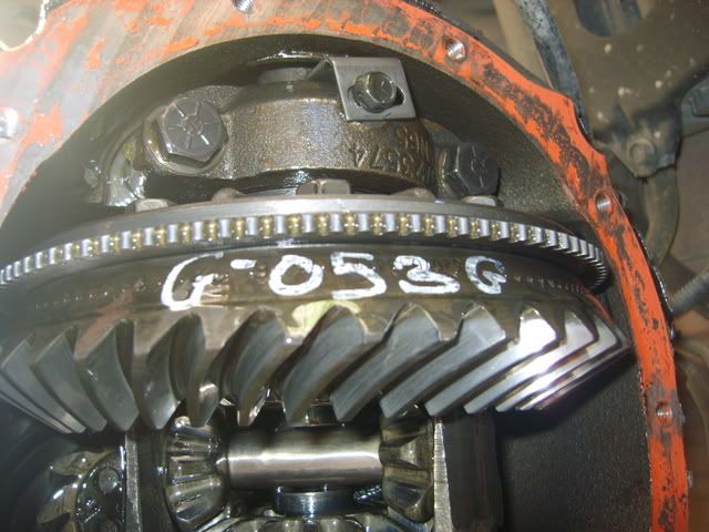

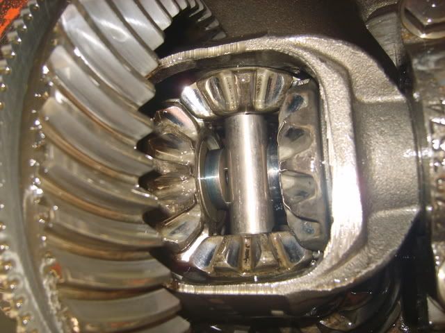

I think this might be a TracLok, but I'm not sure. If it is, it's worn out at 78000 miles.

PostPosted: Tue Sep 09, 2008 8:04 am
You have the open diff.

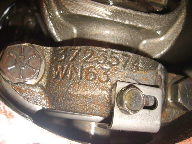

I don't recall mine having that "pin" in the carrier.

yeah me too but its been a while since the Trutrac has been in.

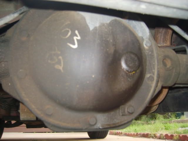

TJKJ2002,
I'm wanting to know so I can pick the proper locker. Not that I'm doubting you but can you explain the difference in appearance to me. Also can you tell if I have the Dana 35 or the Corporate 8.25 Here's the pic of the pumpkin. I've read around as to what the difference is supposed to be, but I can't tell.

PostPosted: Tue Sep 09, 2008 10:56 am
from the shape of it and the 8.25 have the flat bottom, and if you really want to make sure another way to check is to get your build sheet

PostPosted: Tue Sep 09, 2008 7:47 pm
You have the 8.25 diff and it is open since you have clearly visable spider gears.Any full carrier locker/LSD replacement for the 8.25 will work or get the lunchbox loxker for the open diff carrier.
PostPosted: Tue Sep 09, 2008 7:49 pm
If you didn't have that pin in the carrier you would not get far since it is holding the axles in place,meaning the axles can not move inwards letting the C-clips that actually hold the axles in to fall out.
