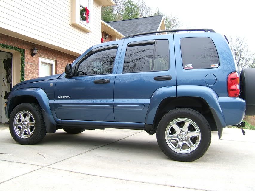

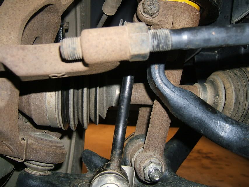

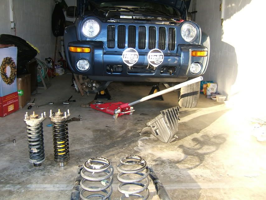

Finally got my lift on!! Went great other than me killing one of the nuts that holds the upper ball joint, dealership had some extras. Heres the pics!

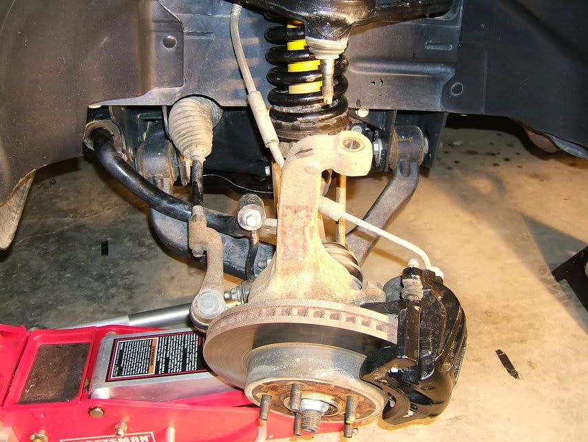

During:
I was afriad of the cv angles after the lift. But they are actually better after the lift than before. They were angled up more than they are angled down now. PERFECT!

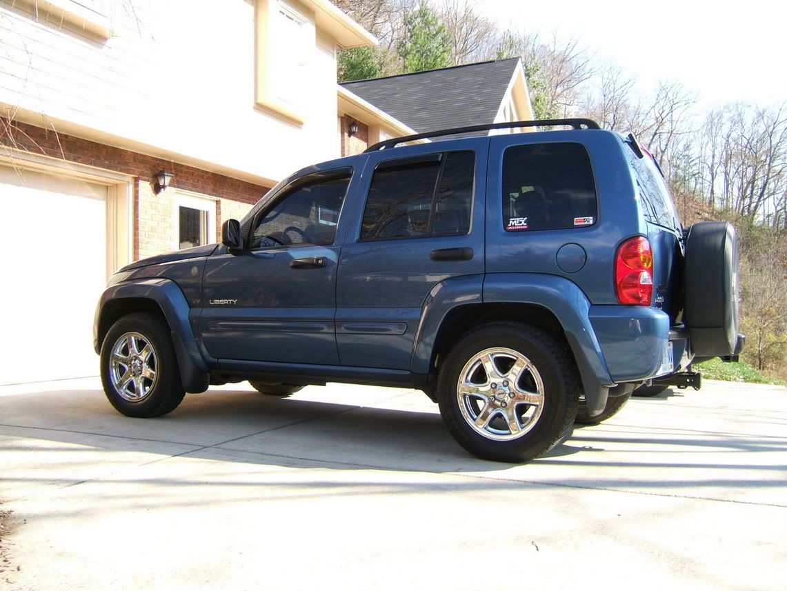

Before:
After:

Amount of lift I recieved.
Front left Fender:1.1in
Front right fender:1.1in
Right rear fender:2.32in
left rear fender: 2.25in
Hitch: 2.63in
Front skid:1.5in
Dont know how i got more lift at the skid than i did at the fender? Must of measured something wrong.

I suppose it is an OME lift, right? I have mixed feelings about that lift, maybe I'll get not enough lift if I mount it on my 2.5 CRD. Which springs did you use ?. Which engine has your Liberty?
I love the OME quality but no so much the typical 'nose dive' of their kits (1.5 front,2,30 rear...and probably the front will settle a bit more than the rear..).
Cheers
PostPosted: Thu Dec 01, 2005 5:59 pm
its the ome like you said. I bought the front springs and rear shocks off of a guy on here. So the rear springs are new, im hoping the rear will settle some and thats why its so high in the rear. The front springs have around 10k miles on them, so they are already broken in. Ill post some more pics in the post above.Front and rear are medium duty springs and i have the 3.7 engine. If it doesnt settle then all you have to do is give it alittle clevis lift to level it out. No biggie. And it rides alot better i think. On small bumps its about the same, but on big ones it really makes a difference. Speed bumps are alittle softer, not as much as i was hoping though. Im getting alittle noise out of the front too, dont know if its a bad shock or what. ill re torque everything after a few miles and see if it stops.

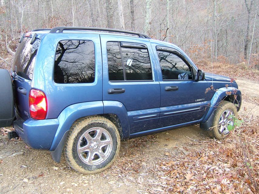

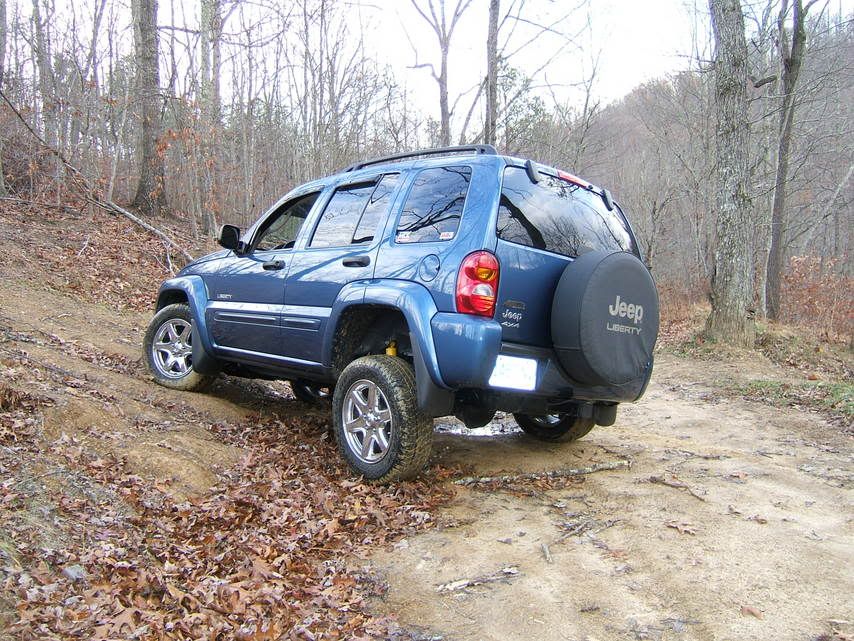

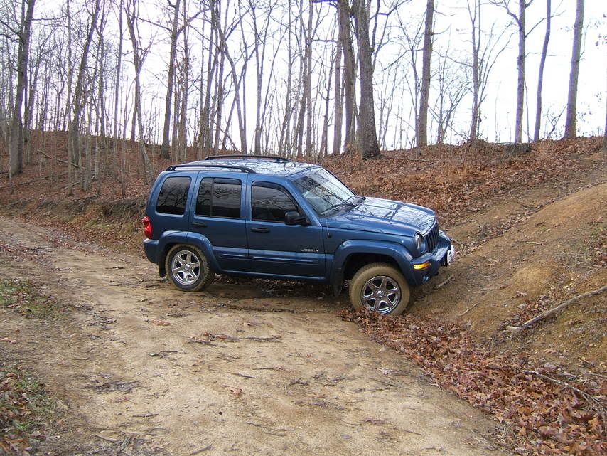

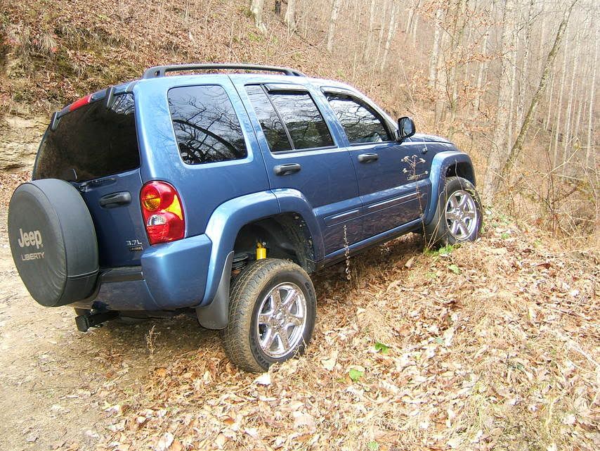

Just went to see how the flex is. Hope you all like pictures.

they stuff well
