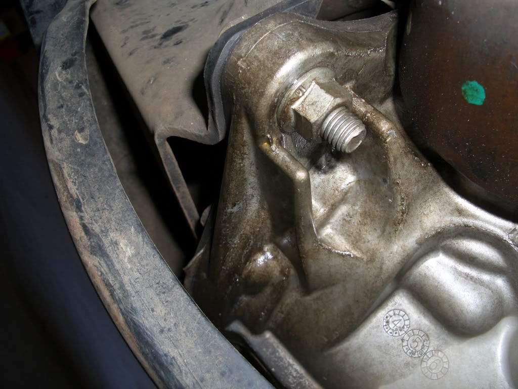

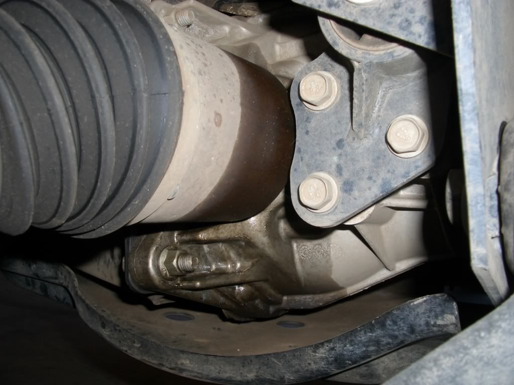

So I was banging on my Pinch welds today, and noticed something that I did not want to see on my Drivers side front driveline:
It seems like a slow leak, and have not noticed any drips on my garage floor or inside the skid plate you see there under the front diff.... It definately has an oily texture & smell... There is a slight bit of "in & out" play with the driveline, but no left & right/up & down play....
Ugh, this must be what I get for Frankenlifting my rig.... What's this gonna cost me to fix?

Ah, the sweet smell of gear oil just lingers in your nostrols, doesn't it? Keep tabs on your differential gear oil until you get a new axle seal in it.

So this is a shot axle seal then? How involved is replacement?

it's a lot of darn work for a $3 dollar rubber seal......

$7029.79 hahhahaha j/k but yea, get a $3 seal and get that crap in, no big deal if you know what you're doing.

Chris, where did you get axle seals for $3.00?
I'm pretty sure mine were $13.88 ea. at NAPA.

I think he was exaggerating, but they are pretty cheap. The pain is the work trying to get that seal out, PITA! Mine took tools, cursing and bloody knuckles to get out. BUt I did it all myself and that is what makes it all worth while. :lol:

Use a Burnomatic torch to heat up the diff (after you've drained it) and get a strong axle-seal puller. Think expansion :D

The curved end of a crowbar worked for me. One little jerk and it was out.
