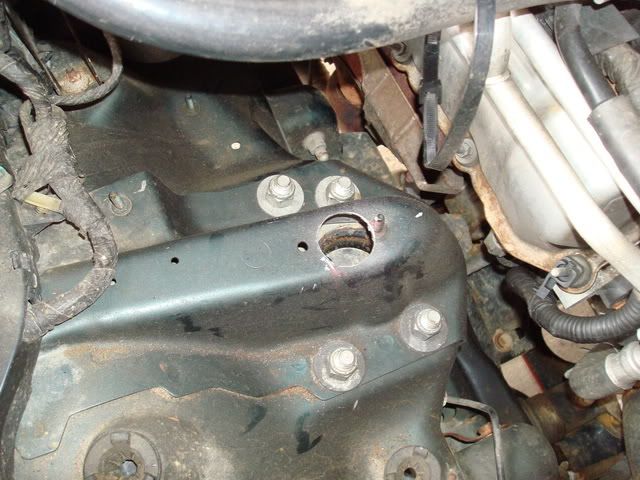

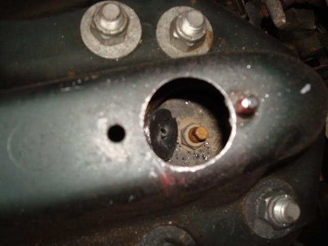

ok so here is what i did. i used a hole saw bit and cut a hole at the top of the strut tower to gain access to the strut nut.
i did this to both sides, had the to take the battry tray out and all

Well first off you now just weakened the upper strut mount from drilling that big hole,and not to mention no water and other junk can sit in that area corroding stuff faster.Second you can't properly tighten that upper nut since you need to hold the strut rod with a 8mm wrench(the 2 flat spots pocking out of the top side of the nut) while using a crowsfoot on a torque wrench to torque the nut,A whole lot of work to have to do it the right way anyway since that strut rod will turn with the nut unless held by a wrench.
PostPosted: Fri Jul 11, 2008 11:43 am
The time spent cutting holes etc was wasted, you could of had the whole assembly out in that lenghth of time and did the job right.
Just my 2 cents but....... :wink: If a job is worth doing , its worth doing right.

well i talked to my body worj frame guy, and he said that it would not effect the way stress of the strut tower at all and yes i did cover the holes with flat rubber caps that way nothing can get in the holes that i made. all of this wwork and its all fixed, no more knocking noise in the front or rattling noise, so all in all i think it worked. oh and the time spent doing this with taking everything out that needed to be taken out, with air tools, a total of 45 mins. so if anyone thinks that they can take the assembly off in that time, well good for you. but i did find out one thing that im gonna have to replace the bushings at the top real soon.
PostPosted: Sat Jul 12, 2008 8:27 pm
I can pull both sides out and put them back in in less then 2 hours(no air tools,use my 28V electric impact when I can),it's not hard at all to pull the strut assemblies.With air tools I can pull and install both strut assemblies in about a 1 1/2 hours,maybe a little less.
