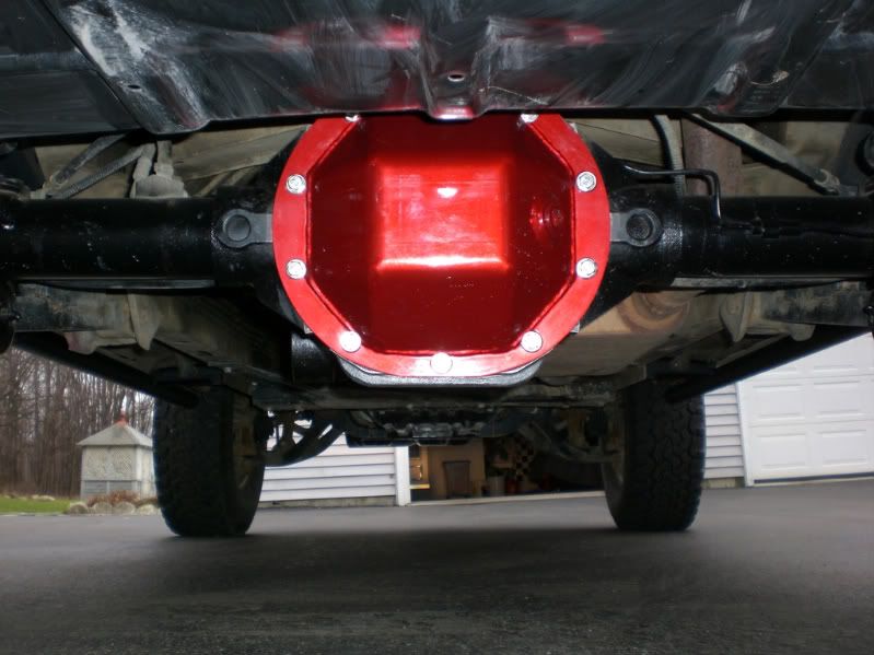

Ruff Stuff makes one. http://www.ruffstuffspecialties.com/cat ... 8a74bc29bc
Here is my old one that I sold.
My Jeep Build ----> Big Black

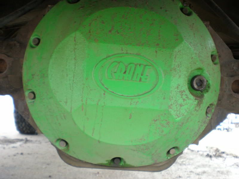

 Post subject: I have the Crane diff cover
PostPosted: Tue Jan 06, 2009 10:24 pm
Posts: 5827
http://www.cranehiclearance.com/crane1_011.htm

Depends on the type of wheeling you'll do. If you won't be bashing things on rocks then a plug may be a nice thing for you. I asked around before I bought my Ruff Stuff and no one had ever heard of breaking a plug on the trail but it is obviously possible. It didn't bother me until I bashed the cover on a rock and went back to check it out and if I had been 2 more inches to the left, it would have smashed on the plug. Would it have broke? Who knows, but it did make me really worry after that. My new Rockcrusher doesn't have the plug and I don't miss it. So if you just want some more protection and aren't really going to be crawling around on rocks then a diff cover with a plug could be the way to go.
Side note, those Ruff Stuff are guaranteed for life from top to bottom, but I had 2 that both had tiny leaks in the welds. Dan at RS replaced the first and offered to replace the second both for free, but I wanted something else.

Crane looks good and fits perfectly! and its made from solid 3/8"
