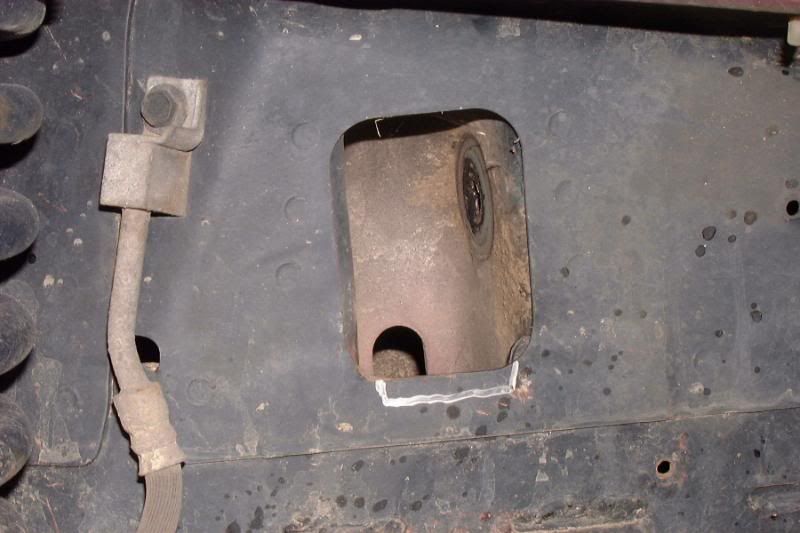

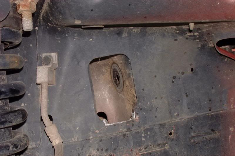

You may want to clearance the pockets for more droop (don't know if that makes a difference on CRD)

I see you have the Frankenlift IIp or full OME stuff, you'll have to widen the front pocket. Like I did. Before you connect the UCA just check how much clearance you need.
