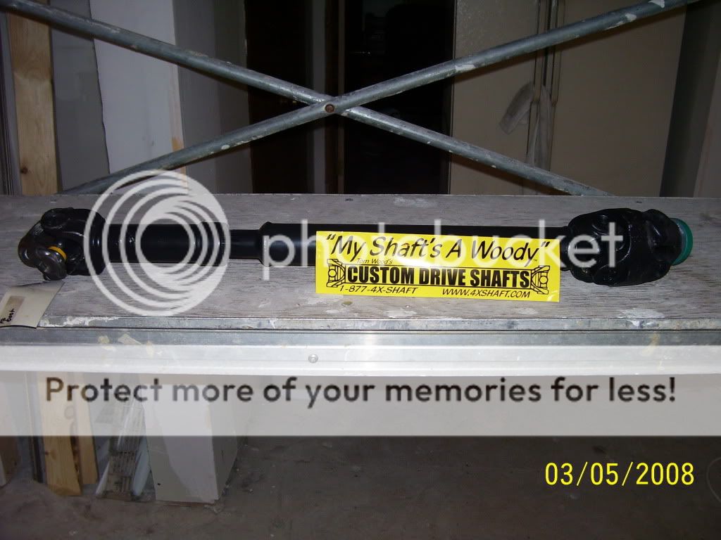

I know that you can get Tom Woods shafts in stock lengths.

PostPosted: Tue Jul 14, 2009 5:57 pm
Posts: 536
That looks just like the one they put in the front of my heep. How could I tell if it was a Tom Woods?
