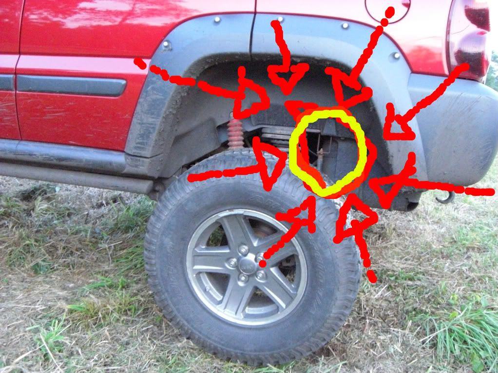

PostPosted: Mon Feb 09, 2009 7:28 pm
hope this helps

2006 KJ wrote:
hope this helps
You forgot one since the '06-'07 KJ's have 2 brake lines back there.
dieselenthusiast
loosvelt, it looks like KJ 2006 beat me to it. The bracket is nothing more than 3" X 2" square tubing that Rock Lizard fabricated for me.
We made 2 brake line extensions,both on the R/R side when we installed your FrankinLift.

i only have the one that i showed.. and as you can see that's at almost full flex and it's not bangoed... i've never heard of anyone using a 2nd brake line relocation bracket... but i guess if i lose my back brakes someday i'll know what needs done!
