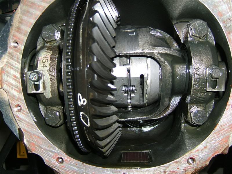

Ive always wondered if the front has one to. Would be nice if we could clean it but o-well. :?
Rear diff magnet, you can see it sitting in the bottom. Its nothing like the magnet you have now but it usually has some fine stuff on it.
Oddly enough, when I changed out the oil in my bros 8.25 in his xj last time it didnt have a magnet. Could of sworn it did the first time I changed the oil. :shock:
