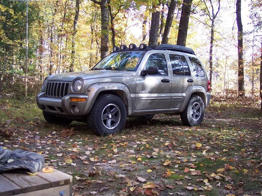

D'oh, forgot to post a pic of it. Here it is in northern michigan at my family's property after I removed the factory side-steps.
PostPosted: Mon Feb 16, 2009 2:32 pm
RenegadeMatt wrote:
I lucked out mine was used and the kid before me had it painted to match his. But 150/200 depending on where you live for the paint. May find someone that is doing a black vehicle and they can paint it at the same time :wink:
Nice area , how far "north " is that? Since moving to the Toledo area have only been about 1/2 way up through Michigan, hope to make some trips father north to find some areas to play this summer

Flat (ugly) :lol: :lol: hoods did not appear until 05 I think it was I know it wasn't in 04 for sure
which I had his rear flares :twisted: have a set of front ones already painted and waiting , rear ones, a RL rear bumper and I would almost be happy :shock: :shock: :wink:
http://maps.google.com/maps?q=chase,+mi ... 58&t=h&z=7
We own approx. 10 acres that is bordered on three sides by 1,000's of acres of state forest. Some killer atv/mx trails all over as well as lots of old, washed-out sandy and hilly two tracks to play around on :twisted:
Thanks!! the flares and styling are what drew me to my Renegade. Nothing like any other Liberty I had ever seen!! I wouldn't have bought my jeep if it had the flat hood (please, no offense intended to those with a flat hood) just not my style.
