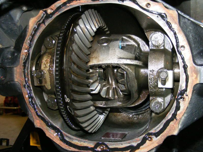

Heres my power trax:
So what youre saying is when you pull the pin out that holds the spider gears in it hits the ring gear? Still cant figure out how you got it out

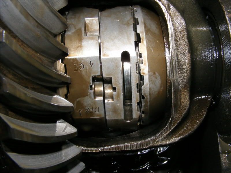

This is easy to get around. All you need to do is grind the gear tooth a bit to allow removal of the cross pin. This is a pretty standard procedure in the world of differentials when running low gear ratios on c/clip style rear axles.
