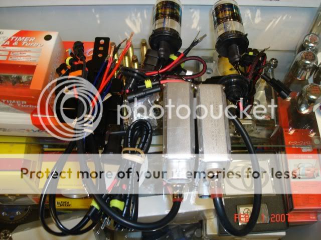

What I did on my jeep is quite simple: get original fog lights that fit in the holes (see ebay auction #370153124750) and after I got a HID kit that fit in with 3500k light (amber). The lightbulb that fits in is a 9145 which is quite similar to H10. You can also get yellow halogen light bulbs (http://www.racinglab.com/nohyyeprohal12.html). Where I live there's a lot of fog and snow so yellow light is the way to go, white light will just glare you. This is just great and I see the road real well. I have to admit that the oem head lights are really not that great. I will upgrade to silverstar asap. I will also add driving lights when I get my arb bumper. (hopefully somewhere this year)
