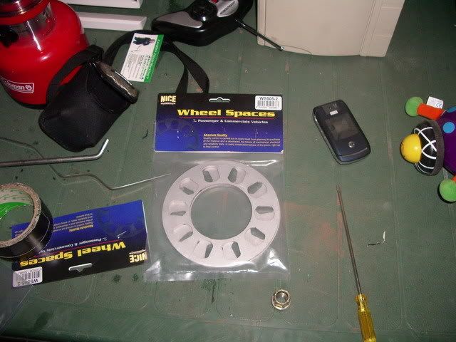

My 5mm wheel spacers cost me about $24 a pair, not really that much. I think the bolt on spacers are a bit more exy. Happy unload mine if that's what your after as I'm not going to use them.
