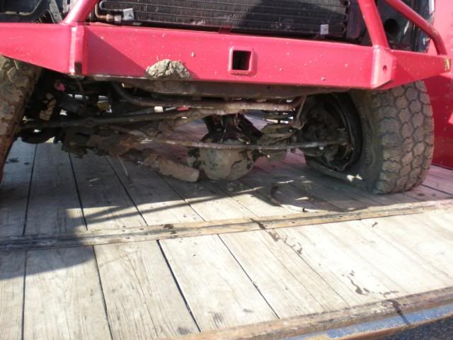

There have been a few front D30A's that have blown,they are aluminum after all.Not one SFA on this board has a TJ front axle in,they all used a XJ HPD30 axle which is stronger then the TJ D30.Oh and most are using 33" tires,one that is running 35" has yet to have problems(but will)and plans on upgrading,the other one sold his SFA KJ with a bent HPD30 housing.

ARBSeth,had the green '02 SFA KJ,sold to a guy in Alaska I believe.

To large of tires for the axle.It's a common problem and a few companies have come up with a fix by using internal sleaves to make the axle tubes thicker and weld on braces for the inner "C's",the also make them for the JK front axles.

Now you see the fallicy of thinking that a HP D30 is "equal to" a better axle, like a D44. I have read that exact thing on the 'net so many times, and I kind of chuckle when I do. Same size axle u-joints in the later years and a more optimal location of the pinion on the ring gear (the only thing the "HP" effects) does not make it the equal to a better axle because of all of the other factors where the better axle is superior. Even a LP d44 is a way better choice. They came under 3/4 ton trucks with 32" tires from the factory, and somehow do not bend. :lol:
There have been enough D30a's explode in the exact same way to show me that there is an issue. Many of them were on stock rigs, at that. But as I have posted before, the D30a is based on the D30, an axle that for 35 years has been considered a weak link good enough just until you could swap it. So the d30a being kinda crappy should not surprise anyone.
SFA guys should get in line with the XJ, Wrangler, Nissan, & Toy folks in trying to find a set of FSJ axles for their swaps.

Nuff said about D30's,LP or HP.......................
And that is why I'm going with a mid '70's Ford HP44 that has 1/2" thick axle tubes,not bending those anytime soon(or ever).
