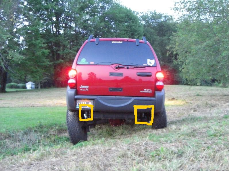

PostPosted: Mon Dec 29, 2008 12:33 am
i added another one.. no need to relocate the exhaust.. and it is mounted the same as the stock one only i added another bolt. so it's actually stronger than the stock one... i figured if on the trail and either i needed to be pulled or needed to pull someone from that side to prevent a roll over or damage.. it would be worth the 5 mins and $30 for another hook on that side
plus it works real well to make a triangle with the strap to create a centered pulling point for your friends who think it's a good idea to tow them on sleds and snowboards when it snows
You never want to make a 'triangle' with tow straps!! Always use only one hook/shackle mount to pull from. If you make a 'triangle' with a strap, not only will the forces be pulling towards the other vehicle (which is what the tow hooks were made to do) but you'll be pushing each of the tow hooks together, and they were not made to do that!!
If you want to pull from more than one spot, use two straps of the same length and attach them to each hook, and then attach them to the same hook on the other vehicle. That will avoid the sideways forces on the hooks!!

PostPosted: Fri Jul 10, 2009 9:25 pm
i only use the triangle to pull my friends on sleds / snowboards (like one friend sitting on a plastic saucer ) in the snow and icy back roads. It's nice because it keeps them centered behind the jeep instead of one side or the other. hahahaha dont worry i know proper pulling technique.. been helping operate my dad's towing business for the past 7 years :) which is why i added a 2nd... because that might be the difference in preventing a roll over or not. the first time i used my tow hooks i used the one i added because it gave a better angle to rescue the wrangler that was stuck behind me :twisted:

Ahh, cool. I'm sure pulling people on a sled would be fine. I just didn't want you to try to pull someone out of the mud and have the hooks rip off!!
