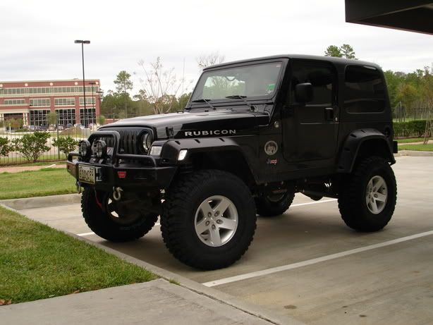

If you only want 2-inches you should consider the 2" Budget Boost. I ran mine until I wanted to go extreme with a RE long arm kit. :D
2" Budget boost
5.5" RE long arm
