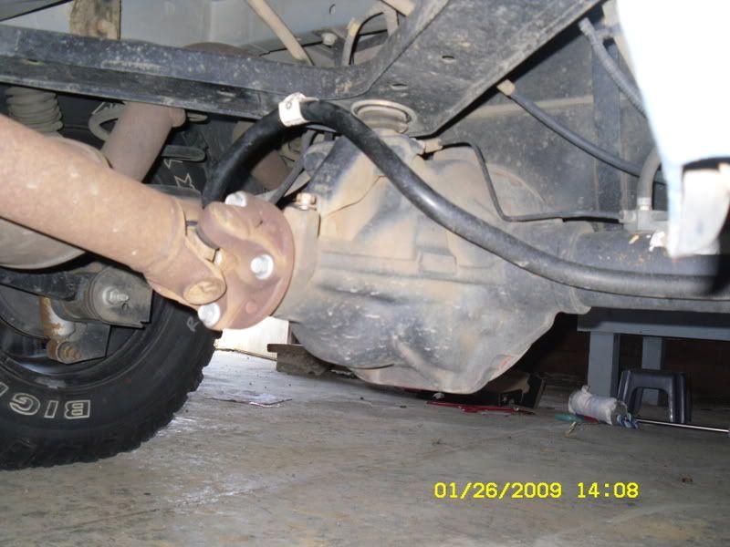

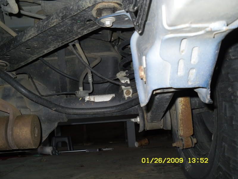

Tried to remove the rear sway bar today. The bolt is smaller than a Craftsman 3/4" but bigger than a Craftsman 11/16" or Made in China 3/4"
I need some more metric tools.
Got the vibration dampener off.
These shocks are less than a year old and already rusting.

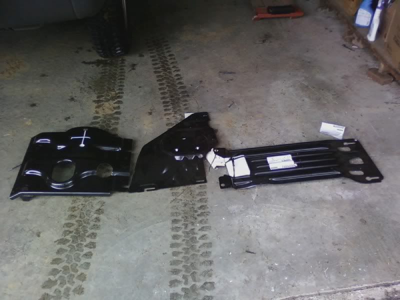

I got my skids today.
Engine, Transfer Case, and Transmission from left to right.
Got my engine and transmission skids on.
That you do, most everything on the Liberty is Metric. According to my math you are looking for a 18mm.
Aaron
You are correct, Sir!

theres something wrong with those skid plates, they have paint on the underside, especially the engine skid! fix that ASAP :wink: haha :lol: :lol: :lol:

I need to pick up a tranny skid cause that is the only one my rene is missing. :(

yea when i bought my jeep used, it had all the skids except the tranny skid as well.
PostPosted: Thu Jan 29, 2009 2:35 pm
Joined: Mon Oct 08, 2007 6:42 pm
Posts: 270
IIRC the tranny skid wasn't added until 04 or 05. You have to mod it to work on the earlier models.

yea i have one now :) 3 bolts hold it in, the front gets sandwiched between engine skid and crossmember, using one of the engine skid bolts, fits perfect

Today I finally removed the rear sway bar, which was a total PITA. I had to remove one tire to get to the bolt so I rotated them too.

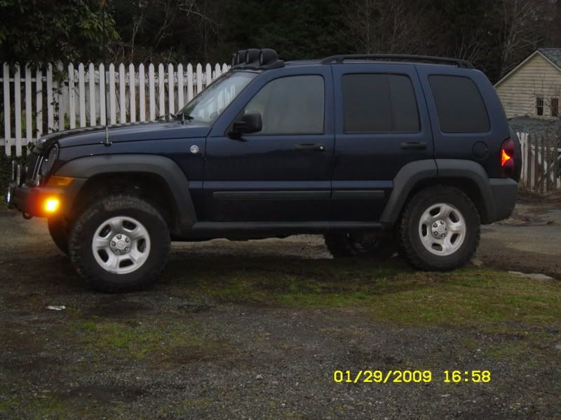

Some no rear swaybar flex shots. I will do the rear bumpstops this weekend, maybe.

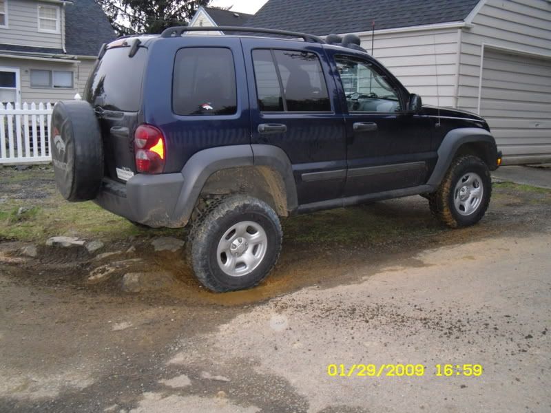

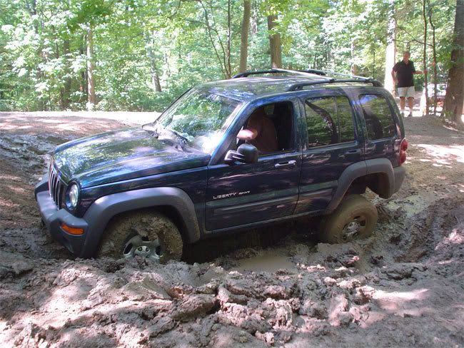

More realistic picture of what your flex will look like:
PostPosted: Fri Jan 30, 2009 12:04 am
Posts: 270
It was in my driveway after all. :D
