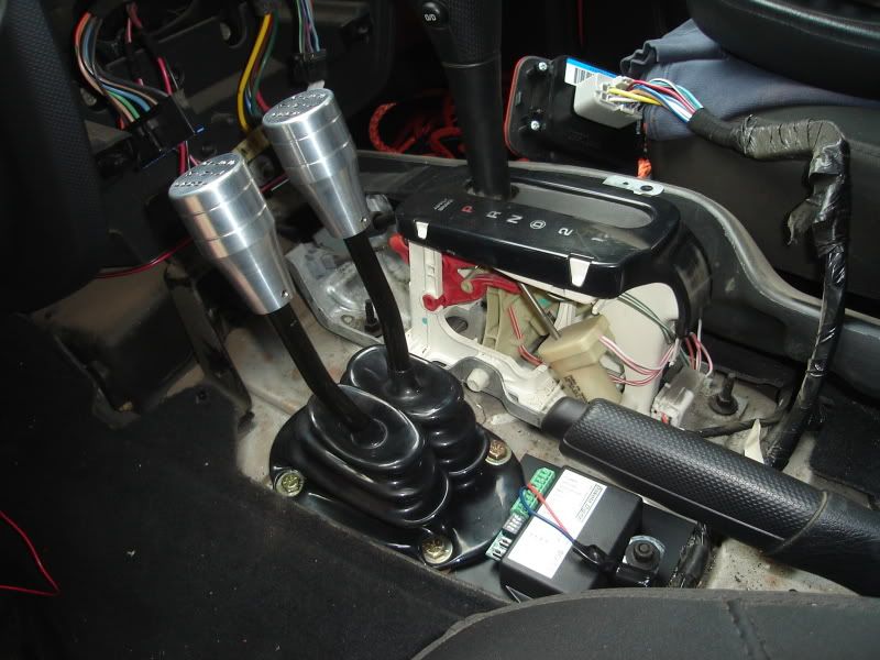

Glad the 231 doesn't have those shifting issues,positive engagement band positive dis-engagement.
Or better yet twin stick it baby 8)
