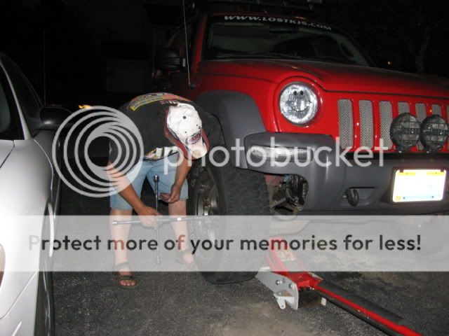

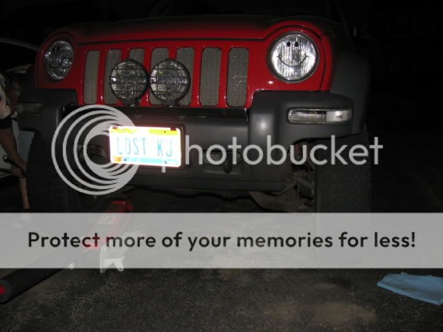

Put masking tape on in the area to cut. Draw out the line you want. Use Jig saw, rotozip, dremmel or any cutting tool. I did mine when the bumper cover was off to install my front hitch so I had no worries about what might be behind the cover.

I've got a similar need: thinking about just getting rid of the knock-outs near the tow-hook mounts and want it to look as "factory" as possible. Obviously the dremmel/drywall saws, etc will do a good job, but all are either serrated or grinding-type cuts. Has anyone used a cutting guide and a sharp blade to score the plastic deep enough that it snaps or peels apart cleanly, especially on a painted bumper? I was thinking the method used to cut plexiglass would work well and avoid having to clean things up with sandpaper afterwards. Would light use of a heat gun be okay on the painted surface and would that make it easier to cut?

We ( or actually Tom) took a heat gun to the flair and heated until it just started to get a little shiny and just cut right thriugh with a razor knife. I chose to follow the natural line formed by the driving light opening and used the top edge as the line across and inside edge vertically. I had to use a key hole saw on the underneath plastic , it seems to be heavier and a different type as to not soften up like the outer cover.
