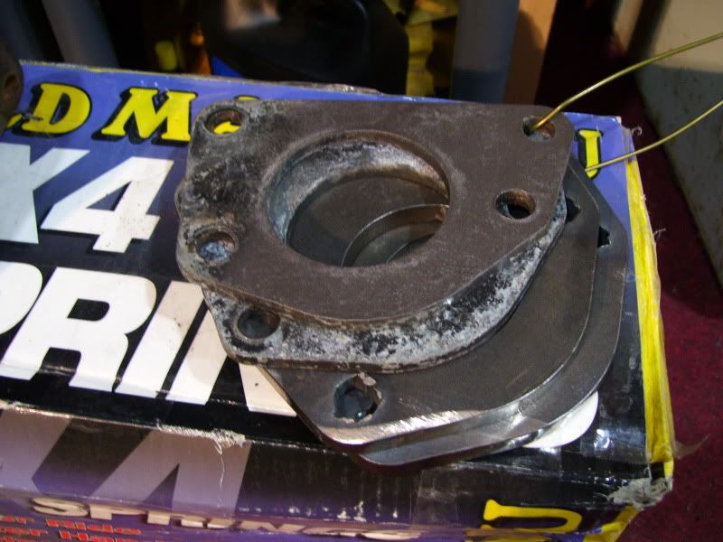

Anybody got a link to a strut spacer so I can get an idea what I'm looking for? Would it be installed in addition to what's already there or be a replacement?

Heres a picture of what they look like, two of these are from Rustys, they are 1/4 inch think other two are like what RRO sells and they are 3/8 inch thick
these just sit on top of the upper mount between it and the unibody
