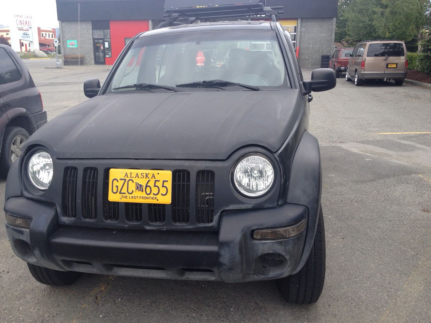

Here's my old girl, an 06 with 81,XXX on the clock. There's a nasty multiple cylinder misfire I cannot fix, over $1K into that dilemma and nothing has changed. Image
