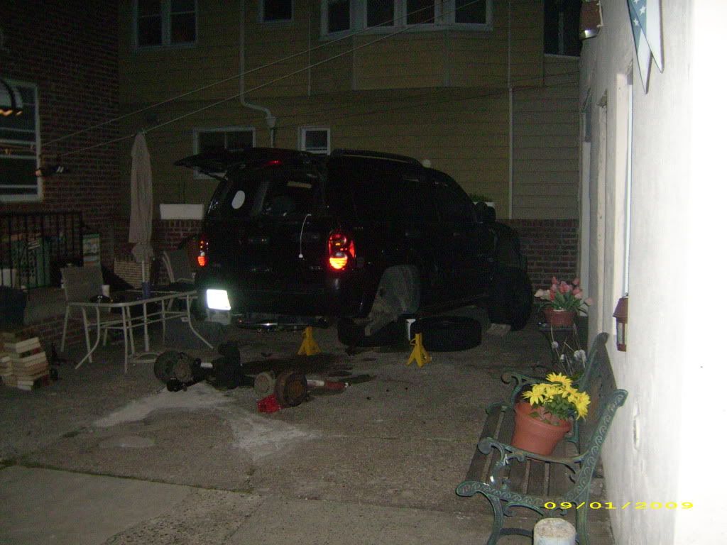

I don't know if they are in alaska or if theres a place close enough... but you can get a used rear for like 100 dollars and up... I changed my own rear in my driveway in about 6 hours with a couple of friends passing me parts / tools... The first place I check is car-part.com... its a huge list of auto wreckers and sort by price... I find I get the best deals that way.. I go and inspect the parts at whatever yard it is... and 20 / 20 times its worked out GRREAT!
