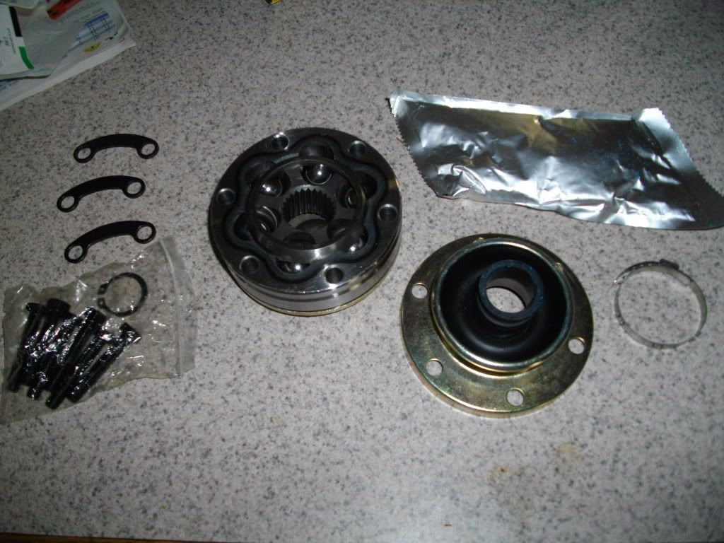

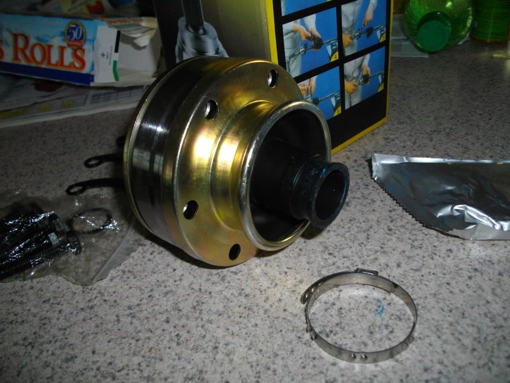

Haha no this isn't spam, I have absolutely nothing to do with this company except for the fact that I am a recent customer. The boot always tears on these driveshaft CV joints, then the grease flys out, the joint drys up and wears out. I just posted this because I figured more people should know this option is out there because I didn't until now. I ordered one of these and got it in the mail today. The joint is 3 pieces, the front dust cover, the actual cv joint, and the rear dust cover. The boot is attached to the front dust cover and feels pretty thick and durable but time will tell. As for fitting a 2006, I'm not sure. You may have to call them on that one.
Pics

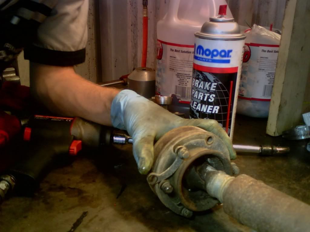

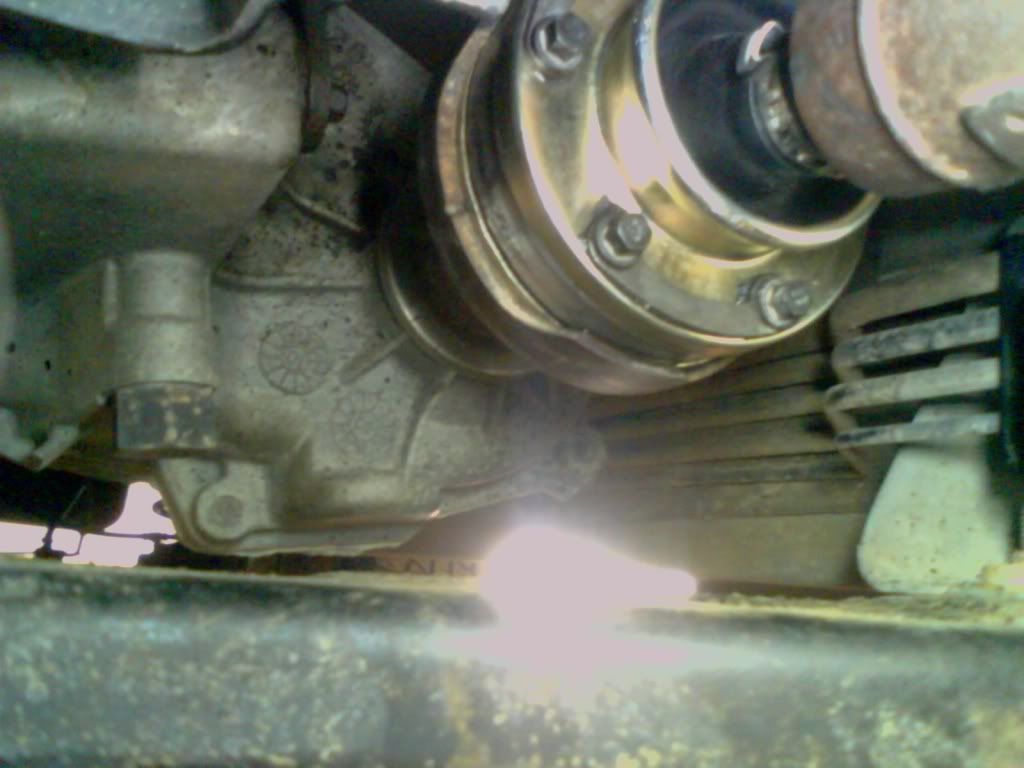

Did the install of the CV joint on my liberty. It was more difficult than I expected, essentially it was just pop the rear dust cover off, remove the snap ring, then slide off the bad cv joint. However my joint was so rusty inside that it was seized to the end of the driveshaft. I ended up cutting the old joint off but long story short here are pics. Sorry they're not very good, I had to use my laptop webcam to snap the shots.
Hope it holds up well
03 KJ - OME 927/948 - 3 ring clevis - 1 extra upper per side
