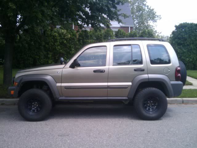

Country_Rob wrote:
Are the isolators to make front and rear level? Should these be installed right away?
Personally, I would add TWO (2) UPPER ISOs to the rear on each side. I added one during the initial install, my front end is noticeably taller with just one extra, and it annoys me. I will be adding another shortly.
It's hard to tell in the picture, but I see it every morning walking to my car.
viewtopic.php?p=601861#p601861
