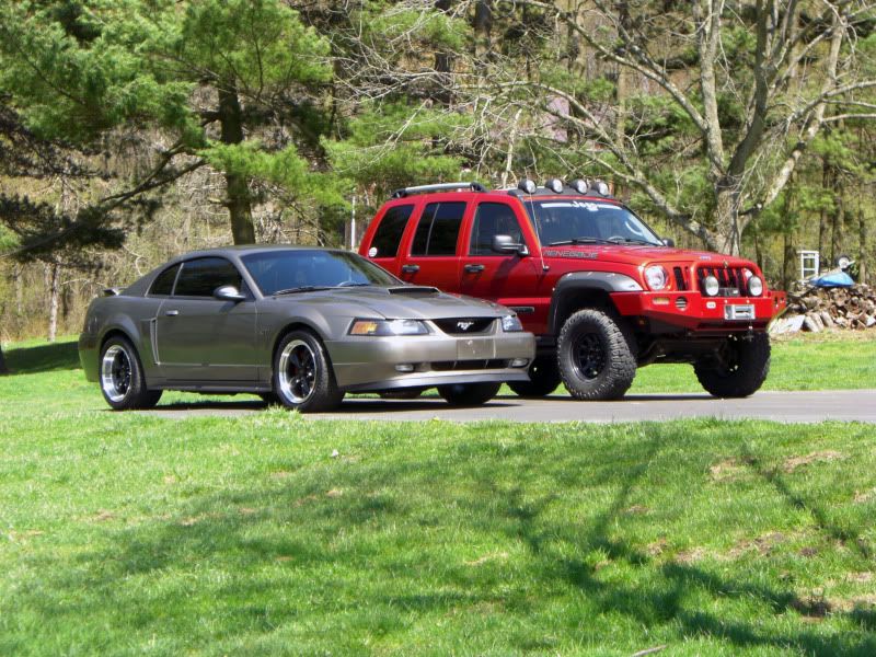

here's my gasser frankie with OME790's. i changed the springs after putting on the arb/winch. I was the first one to do it and everyone told me i'd die if i tried to put 790's in with my franky (seriously they did). and it has worked great for me for the past 20k miles... and i wheel the snot out of it. The rear is just the rear frankenlift with one extra upper iso. If i want higher i can add another upper rear iso. If i want higher in the front i can still do 1-2 or 3 conduit nut clevis lift. if i added 2 or 3 clevis lift my CV's would be absolutely maxed. right now the CV's are boarderline but on the happy side of boarder line. clevis lift would put them on the sad side of boarderline
so i'd suggest just keeping your gasser frankenlift just swap the springs to 790's and see how you like it. can always add the clevis if you want more but i bet you'll be happy. My jeep nose dived when hitting the brakes and i could feel it sway around corners more after adding the bumper/winch... putting on the 790's put it right back to how the frankenlift handled with stock bumper! couldnt be happier.
left front- 22 3/4
right front - 22 3/4
left rear- 22
right rear 22
